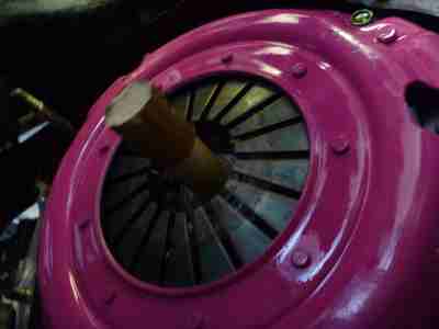

30.use a clutch alining tool or lathe up the end of the broom stick to fit the clutch plate and cover onto flywheel.

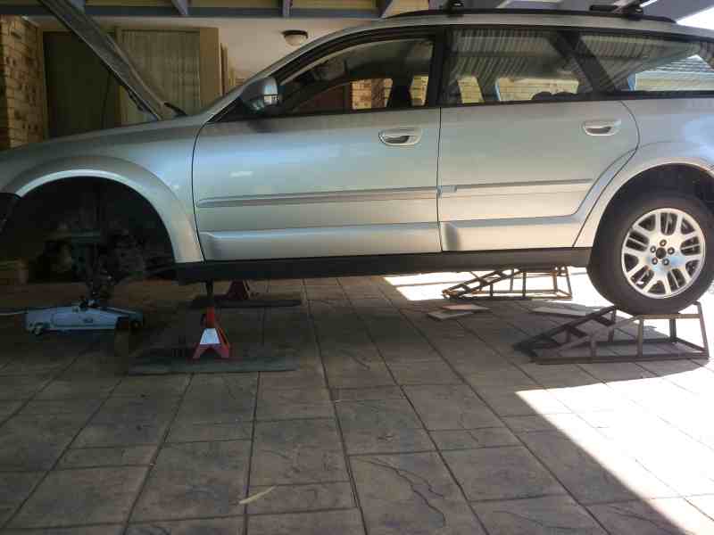

1. You need to get the car high off the ground and level so the gearbox will just slide straight off the shaft i reversed the car onto the ramps apply handbrake, then put put stands under the front.remove front wheels.

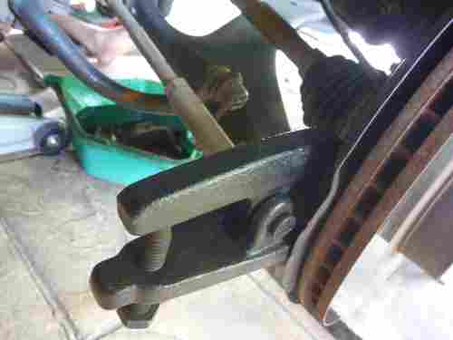

12. remove steering arm from hub use a puller dont hit it with a hammer

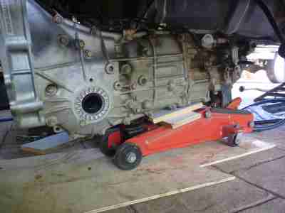

25.lying on the ground next to the gearbox gently rock the gearbox off the engine then role it back with the trolly jack while letting the jack down slowly secure the gearbox to the jack so it wont role off.

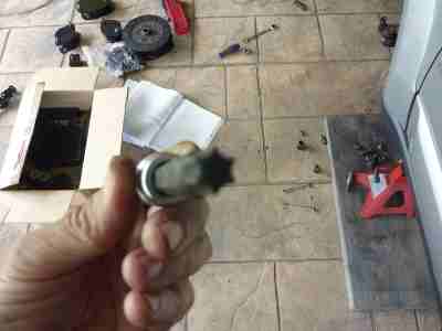

27.remove the crap dual mass flywheel from the engine with a long shank torx plus 50 tool

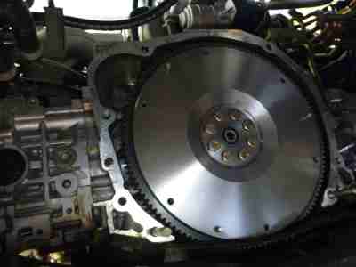

29.clean the new solid mass flywheel with metho to remove grease and use
rubber gloves to install new flywheel
