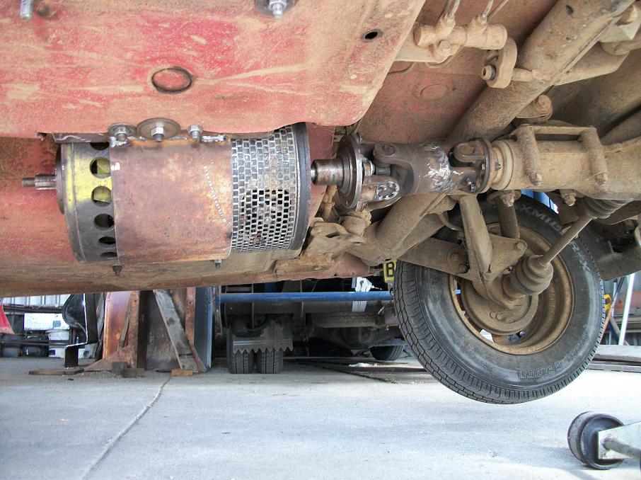

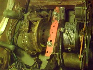

Hi, Brian from Hunter Valley. I would like to obtain a schematic diagram of the bolt pattern motor to gearbox for a 1989 L series 4wd wagon, Australian model. It is a 1.8 L carby engine. At the moment it is a hybrid with a 36V motor driving the rear diff. This works but the 3.7:1 ratio is too high for the motor. Previously I had this motor in a 1968 Hillman Hunter and it drove through the 4spd box, starting in 2nd and travelling in 3rd with a diff ratio of 3.9:1 and I want to try this on the Suby. It would save downtime if I had the adaptor plate already made, as this car is used daily. Hope to hear from you soon. Thank You.

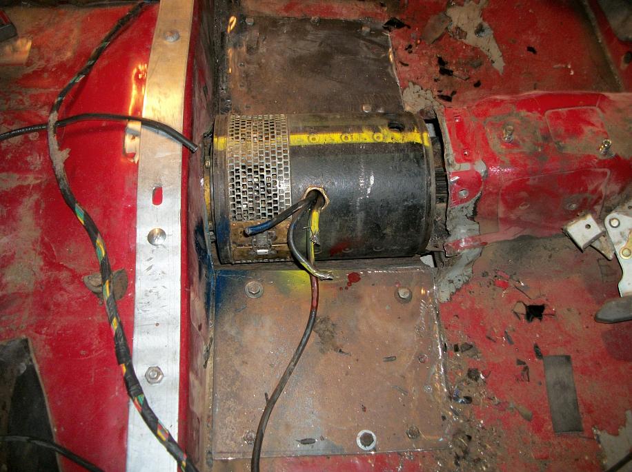

Yes; car still has fwd fully operational. Pics show early fitment of forklift motor. Motor is really too small for this car and would be better in the small subaru that weighs 650 kg. Batteries are old forklift batteries and run down quickly. Top speed is only 40kmh on level ground with 4.5k distance.Interestingly the Prius Hybrid has a range of 3km on battery alone.
If anyone decides to do a similar project use at least 72v with LifPo batteries.
DIY Electric Car Forums is the website. Hope the pics attach ok. Some will be of the Hillman Hunter with the motor on the gearbox
