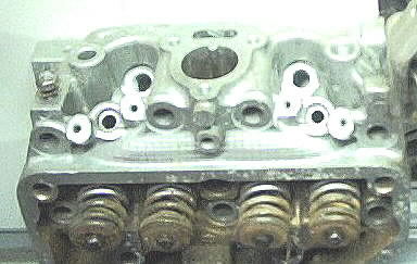

Yes there are quite a few variations and information is patchy at best and downright inaccurate at worst regarding what Subaru heads actually are.
Dual port EA81 is actually Dual exhaust ports as the exhaust valves are located at the extremities of the head and in the head they are fully divided.
They do share a common exhaust header.
The biggest advantages of these heads are the exhaust heat is not concerntrated in the centre of the head until well away from the combustion chambers,and most importantly the inlet porting whilst siamesed is pretty much a downdraft almost straight shot at the back of the valve head.
Normal EA81 inlet ports are a long S bend configuration,not good for flow,as are incidentally the EA81 tyrbo heads,these are not in any way related to the Twin Carb EA81,the fact the Twin carb heads do have the exhaust fully isolated until the manifold gasket does mean they are dual port and dual outlet,just side by side at the outlet into a common header pipe.
Placement of the injector bosses in the turbo heads shows they are not the reverse valve heads as some may have assumed,but use the standard EA81 inlet layout

- EA81 Injected Turbo head.jpg (23.98 KiB) Viewed 3295 times
