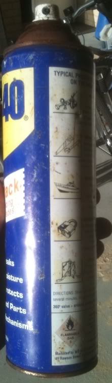

Post by AndrewT » Mon May 31, 2010 1:09 pm
Alex wrote: Good thing wd40 isnt flammable!
mine is...
I think there might be 2 different types. My can is pretty old.

Post by Alex » Mon May 31, 2010 2:15 pm
andrew im pretty sure its flammable only when its coming outta the can(ie the propellant)
once its been sprayed it isnt.
but then again....im pretty sure i remember trying to use wd40 as a flame thrower and it didnt work. So maybe the newer stuff isnt flammable.

WD40 burns really Well!! :P And yes you can make a flame thrower! Don't try at home kids it throws a rather large flame!
