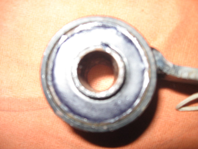

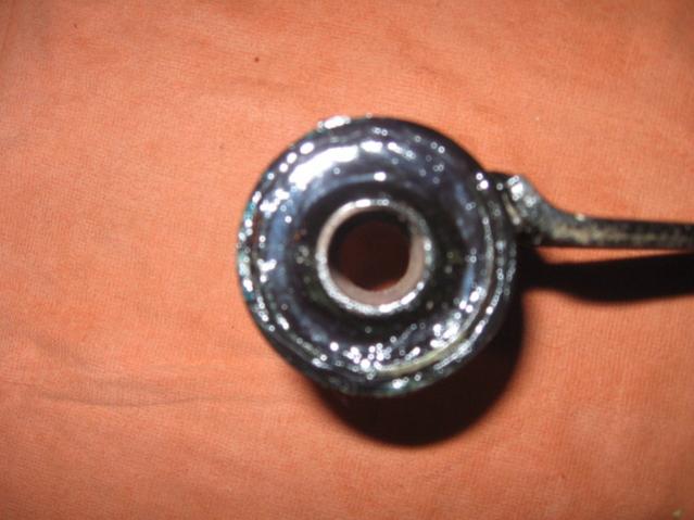

I just recently had a diff hanger and cross member bushes filled with urethane for $50. Even had a choice of colour. The original rubber bushes were left in situ and just filled with urethane to I thinks its 80 grade hardness. much more cost effective than completely re-bushing with superpro or nolethane products. I will take a pic and post it in the next 48hours for those who are interested.
This was done as the original bushes at 280000Ks + were starting to sag and deteriorate. I have spare diff hangers and crossmembers in the meantime..
The bloke that did this for me said that if its to stiff to drill a series of 3mm holes acoordingly until the desired compliance is achieved. He has done many hilux and patrol etc bushes in the past.
These will go in the wagon in a few weeks along with some other improvements.

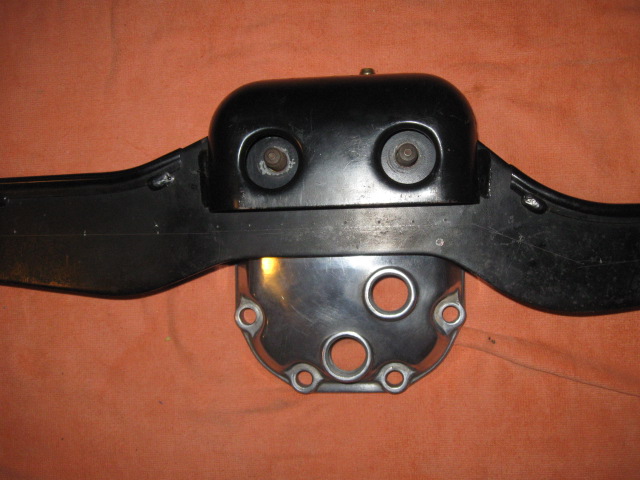

Really not very computer literate, so here goes...
Rear 004.jpg (80.28 KiB) Viewed 8534 times
Rear 003.jpg (96.45 KiB) Viewed 8534 times
Rear 002.jpg (36.69 KiB) Viewed 8534 times
