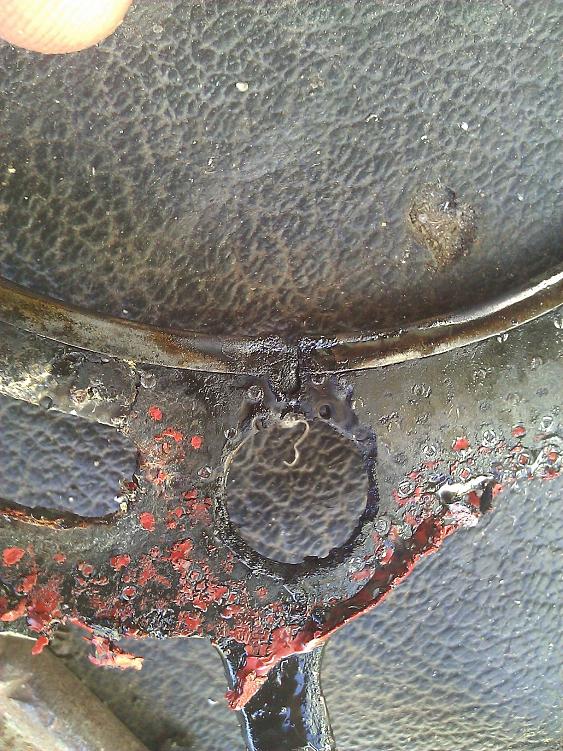

Hi all,
Got all the valves out of the heads and gave everything a quick clean. I plan on sand blasting them anyway. The main thing I wanted to look at was the valve seats and how well they were sealing. Getting the valve springs off with a super dodgy spring clamp proved to be interesting. Took me the good part of 45min to get the springs off the first head. Then I got the hang of how to use them with out them bending no me and managed to do the second in about 10min ;).
Here come the Questions :D :D

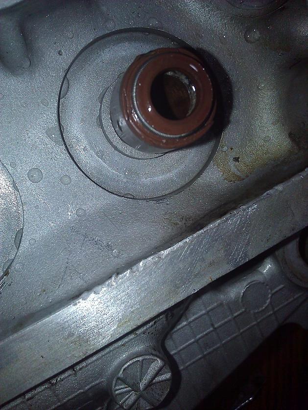

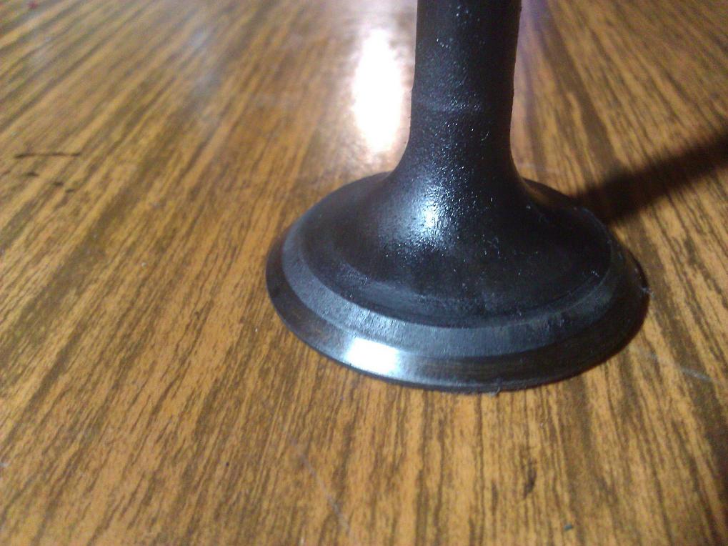

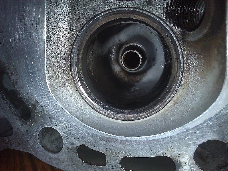

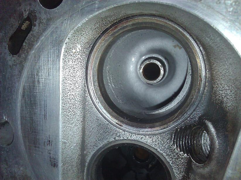

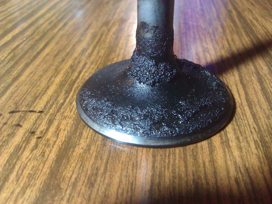

I thought that the EA81 had a single exhaust valve spring and an inner and outer spring on the intake valve. My heads have two springs on every valve. Is this normal or has someone been tinkering?
Does anyone know the service limit of valve guide wear? I can pinch both ends of the valve and feel the slightest of movement in them. Probably unmeasurable without specific gear to do so. If I were to coat them in oil I probably wouldnt feel anything.
Should I be getting carbon buildup in the intake manifold just before it goes through the valve? Its not very heavy, a squirt with some solvent cleaner peels it right off. Put it this way, its nothing like the exhaust valve manifold.
Thats about all the querys I have. Ive rebuilt small stationary motors before and some of my motorcycles, but all my bikes have been 2 strokers so Im still taking stuff in about these silly valve thingies :D. The intake stem seals looked fine too.
Valve seats. Hmm, not the prettiest of things, particually the exhaust ones. Looks like slight carbon "pits" on the faces of the seal, mostly on the valves themselves. All the valves arnt bent so a light lapping will most certainly clean them up 100%. Il wait till I sand blast the heads first though.
Here are some pic's. Parden the quality, they are from my phone :(.
Doug
