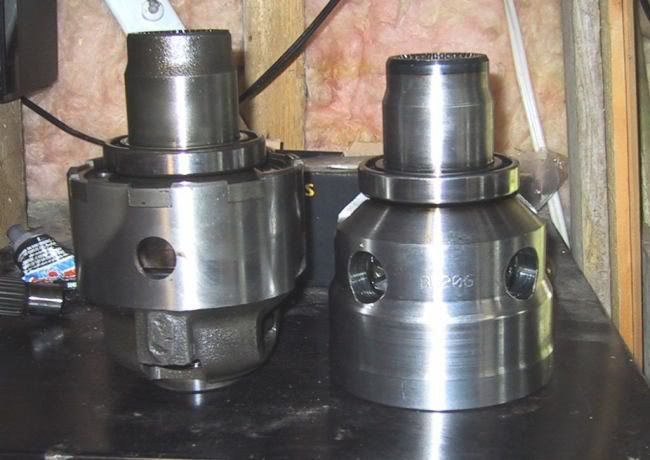

Im sorry Bennie, but the LSD operates both ways.
I have not "seen" the LSD, but i understand how it works.
Here is a picture of 2. Pre 98 on the left, post 98 on the right

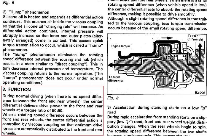

From the FSM
Take note of the "Function" section
Yes the LSD part is at one end, but it couples both the output shafts (via the inner left shaft, and the right shaft in the diagram) so it operates in the way i described in my previous post.
If the front wheels slip, the diff binds and equalizes the torque between the front and rear (essentially locking it). The same happens if the rear wheels slip.

From the FSM

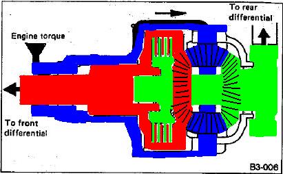

Here is a coloured in diagram showing what the internal parts do. (just a quickie using MS Paint)
- VLSD2.JPG (25.24 KiB) Viewed 3420 times
- Posts: 12704
That makes a pot load more sense, even if it is coloured in using MS paint!Suparoo wrote:I'll have to copy the pages from the FSM and upload them. I'll try to do them later
By the look of that I can't see why a centre diff lock wouldn't be hard to manufacture... The hardest part I reckon would be getting it into the production phase!

They did with the AWD L trans . Manufacturers hate diff locks because the mechanically clueless often enough lock them then drive around on hard surfaces and do damage .
The real clue to how these things work is that the lower or countershaft/layshaft is hollow so it doesn't have to turn with the inner solid pinion shaft but is supported by it .
If you look at the coloured pic note the blue section , the hollow shaft , is driven by the gears on the mainshaft . It drives the would be center diffs hemisphere and therefore the centers planet gears by their support pins .
The blue planet gears drive the red and green side gears , the red being fixed to the solid inner diff pinion shaft and the green driving the transfer gears taking drive up to the shaft the rear tailshaft slides over .
All the viscous coupling does is try to limit the different speeds of each side of the diff center so you don't lose all drive to any of the four driving wheels .
In sedate road use viscous couplings are fine but don't cope very well in competition applications . Once the fluid is well and truly cooked it doesn't work any more . For pure mechanical diffs clutch plate or Torsen centers work better but have some minor side effects .
Anyway back at the locking type AWD boxes . These are different to EJ types in that the forward half or side gear drives the transfer gear and the rear side gear is splined onto the back of the solid inner pinion shaft .
To lock it you simply lock the hollow shaft to the side of the hemisphere with a sliding dog clutch so it direct drives the transfer gears to the rear tailshaft . So instead of the hollow shaft driving the planet gear pins making the planet gears drive the side gears the hollow shaft drives the transfer gear locking the center diff .
Naturally there being two transfer gears they change the direction of rotation so the front differentials pinion turns in the opposite direction to the tailshaft and rear diffs pinion .
Easy as mud , cheers A .
