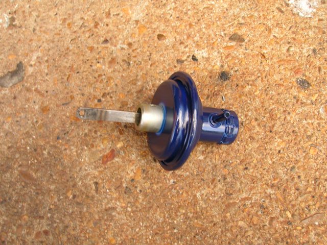

yeah rebuild the diaphram inside the thing - the photo's helped him work out the right spot to place the arm thing
and yeah, can take pic tomorrow
twilightprotege
Posts: 480
Post by twilightprotege » Mon Mar 30, 2009 6:36 pm
pic attached.
why he painted it blue is beyond me, but still better than the nasty old metal look
Post by steptoe » Mon Mar 30, 2009 10:03 pm
I'm impressed at the clean look of this thing. I have opened one up as carefully as I could and it was a mess. Painted generally means reco in some peoples eyes. The worst reco paint job I have seen is the old Electrolux 720 vac cleaners once were orange plastic, painted blue !

Bringing this old thread back because I need a rebuilt diaphragm actuator assembly .
I gather I just send them the actuator now that they know where its "neutral" position is ?

Actually the feller doing the actuator just rang me up , needed Visa number , and to say that the actuator I supplied was quite stiff . He said mostly the diaphragms go stiff and brittle and then split/leak .
The blue colour is a bit gaudy for my old bus so it'll come back black .

The actuator was posted back to me this afternoon and was fitted early this evening .
It made everything a bit smoother and torquier and I think the fuel consumption will improve a little as well .
