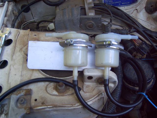

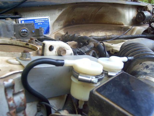

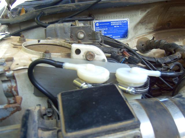

knocked up some g/box and diff breathers for the auto.
Materails:150mm of 40mm ally angle,2 fuel filters,2 hose clamps,1.5m of 5mm poly tube.About 1/2 of time.

just curious why didn't you use a T piece and just the one filter to keep things a little less cluttered however the filter is a good idea ive only seen the breather pipes with a little kink up the top to keep the dust out.

One filter is for the front diff and the other is for the g/box.Being a auto you need to so tranny fluid and diff fluid don't get mixed.

Looks good, and the filters are a good idea. I've only ever seen the pipe kinked or with the little rocker cap on it.

How did you connect up on the gearbox?>

they just push in where the factory (crap) breathers are
