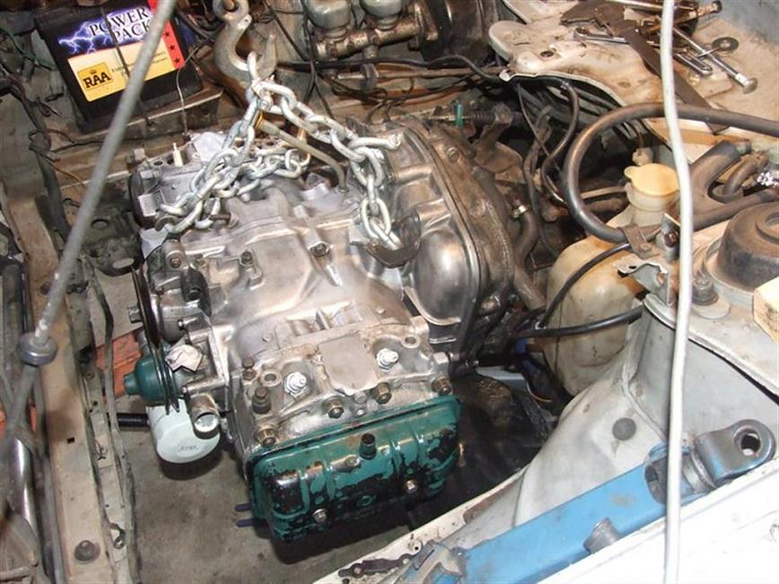

Just wondering if anyone has pics of where to attach the crane to the engine. Hopefully will make sense when I go to do it but, just incase, would be nice to know what to look for.
Thanks
David
Posts: 2952
Post by Silverbullet » Mon Oct 10, 2016 9:15 pm
There should be a steel lifting hook bolted at the front of the engine block, right above the crank pulley. There should also be a steel bracket on the bell housing that you can put a D shackle through.
Here's a (really!) old pic I found on my PC, hopefully you can see the hooks on this pic.
262145_1662423060827_6445695_n (Medium).jpg (104.35 KiB) Viewed 25254 times

Post by David D » Tue Oct 11, 2016 8:23 pm
Thanks, that's just what I need.
