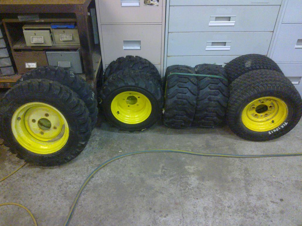

Bogey drive for a little machine.
2 on the right are for the ride on racer. Have everything, just need to make up an axle. And split the cases on the RG250 motor to replace the kick start shaft, cant be bothered, I just know the crank seals will be trouble, never had any luck with them.
2 on the left are for an old bolens ride on with a hydro axle in the back that Im going to tractorafie. IE make look more like a shrink rayed tractor and Ive got a little rotary hoe attachment to mount on the back. Scored some cheap trailer hubs off eBay the other day, silly me, should have asked, bought them home, 4 x 130 pattern, fit these wheels. I got excited, I thought Suby and Peugeot too, my uncle is a Peugeot nut, then the penny dropped. Super bug or type 3, pretty damn useless really or really good score. Jury is still out.
The 4 in the middle are for this project. Ford stud pattern. 18 x 8.5 on a 10" rim. Off a John Deere of some sort.
I wanted 4 of the more tractor looking 12" wheels above but he only had a pair each of two different types left. So I got the matching 4, the 5 stud pattern also sold me.
