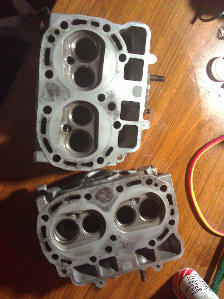

Thats because I cleaned it :D. Sort of. Its getting a sandblast.
Doug
Posts: 2952
Post by Silverbullet » Tue Oct 09, 2012 4:39 pm
I'm probably pointing out the obvious here but you need to take those valve stem seals out before the sand blast :rolleyes: And new ones installed after and set to the right height. I think an 11mm socket clips over them nicely to tap them down without damage.

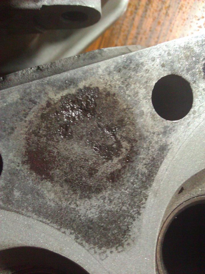

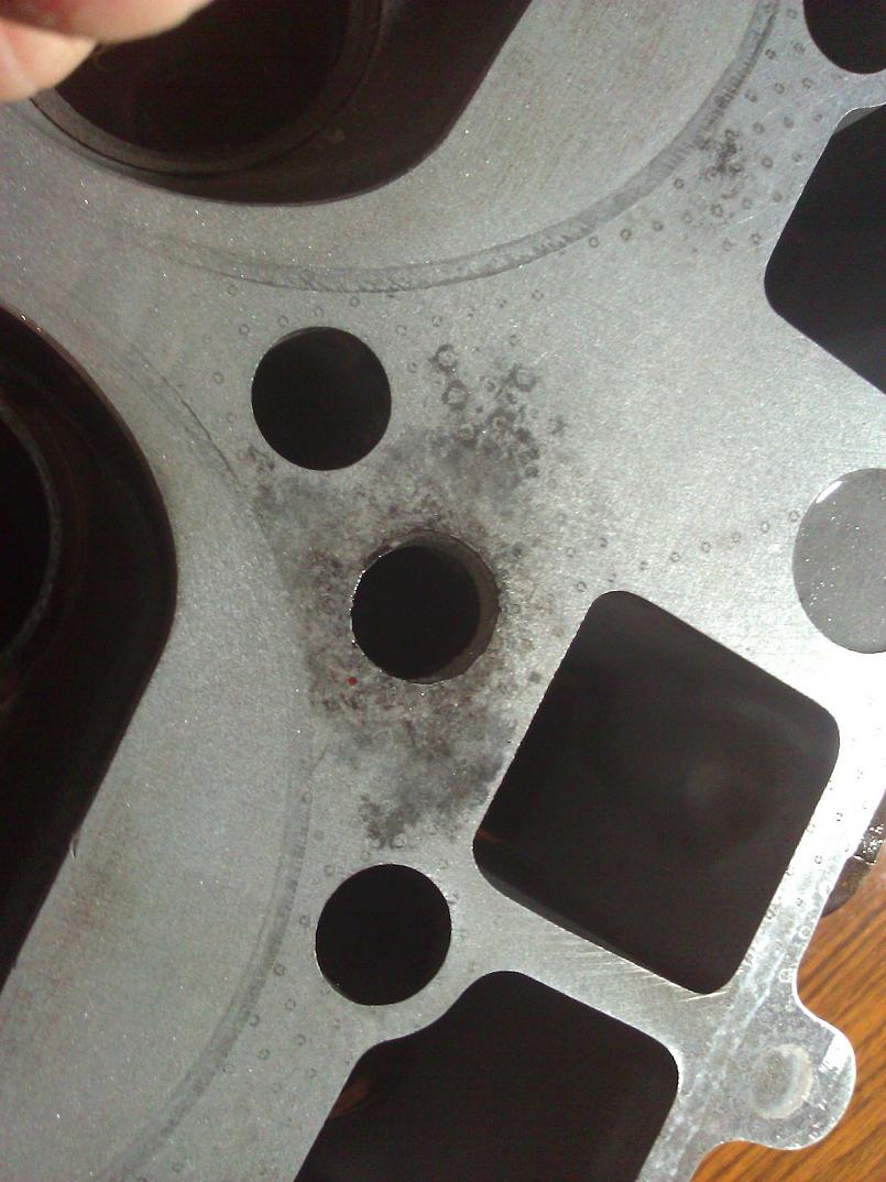

Hey Fellas,
After a light sandblast today I got out the elbow grease and gave the heads a once over. I think Im gonna need to surface them. Too corroded. What do you think?
Doug
Post by steptoe » Tue Oct 09, 2012 9:21 pm
a little skim will help the gasket sealing, help allay any worries you might be scrimping and risk a failure.....
Subydoug
Posts: 988
Location: Carlisle WA
Post by Subydoug » Tue Oct 09, 2012 9:37 pm
Spoke to the boss. Going to give it a lite sand. The corrosion is not too bad and it isnt at the combustion area of the head.
Doug
Post by TOONGA » Wed Oct 10, 2012 9:17 am
Get yourself a nice thick flat sheet of glass or stone (about 2 -3 times as big as the head) and cover it with a coarse grade of garnet paper (100 -180) then using a figure of 8 motion and water to keep the paper usable you can face your heads.
While most people recommend skimming them, this works on the same principle and doesn't remove as much meat from the heads.
