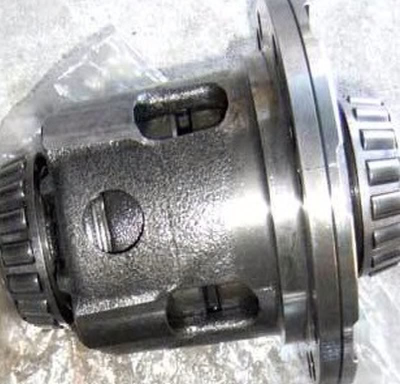

3) does the LSD come as just the centre? If so you'll need to fit it inside your current diff, or find another diff of the same ratio that you need to have it fitted to. Andrew T has done a write up about it (search ;))
taza wrote:Im really keen to put the auto locker in the Foz in the next few weeks and want to put it in myself!
Well if it's a diff centre like this:
Stolen from Rex net
You'll need to have it fitted as a replacement centre to the one in your diff at the moment - or have another rear diff on hand so you can swap them as a whole unit like this:
You'll need to find out if you have diff output stubs or the female setup as above to make sure it's a direct fit.
