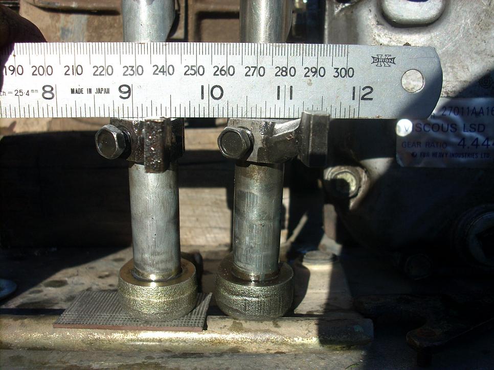

My suspicions were correct, it was the detent fork/ selector that had been bent and was straightened by me that was the problem area. Nothing wrong with the gears thankfully so after comparing bits and pieces have come to the conclusion that the detent arm is near critical for good shifting and feel. My straightening effort was off by about 2mm, doesn't sound much but was slightly crooked too, as well as that the shaft needed linishing to take out a couple of (very slight) high spots. It turns out the selector finger was going too far and jamming behind the spring loaded barrel piece, if I had reached down with a 10mm spanner through the shifter hole I could have got gears again to get home as it turns out. Used the good Impreza arm and fork though in the Brumby because that was in perfect nick. Wow, it now shifts with one finger on the lever! Beautiful feel too. Used the crappy straightened shaft back into the spare Impreza box with an L series fork and only getting 3-4, 5-R changes so it looks like another proper detent finger coming up in the future for that box:o

This is a photo I took yesterday to show the difference between the Impreza selector shaft and the dodgy one previously installed and straightened to show how a little tiny misalignment can throw everything out. It looks like a lot but when you see the scale from the ruler it isn't much at all.
