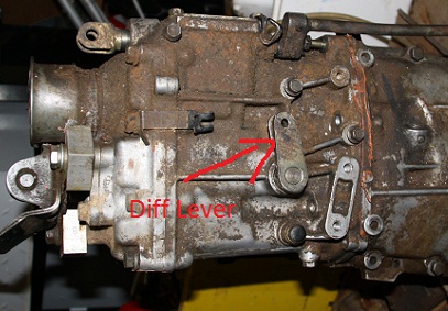

pic extention housing
didnt realise the one in my shed is dual range
- IMG_3974.JPG (74.26 KiB) Viewed 4806 times
Awesome... so if it has that lever in the pic then it is AWD. And does the lever simply just turn AWD on and off? Wouldn't you just want it on all the time or is this different from the never AWD systems.

the lever locks the centre diff going from awd to 4wd
the center diff is also not the viscous type its planetry and gives a 50/50 split
the old 4wd lever becomes low range only
and putting the rear housing on an lseries box is not possible
i have to pull this box apart soon to put in the l low range so ill take some more pics

in the photo you can see the low range slector shaft go through the housing

Yes Brumbyrunner is right , all the EA82 AWD boxes have 3.7 ratio diffs in them .
The ONLY exception is the AWD Vortex XT6 with the ER27 2.7L flat 6 , they ALL have 3.9 ratio diffs .
The options go like this .
1) AWD Vortex XT4 (EA82/T) 3.7 diff and wider L Turbo gear ratios . SR only .
2) JDM/USDM RX L Series , as above and with with taller RX low range ratio .
3) AWD Vortex XT6 , same as (1) with 3.9 ratio diff .
Fact : L type AWD gearboxes use a unique front diff pinion which doesn't fit any other gearbox period , inc the later EJ AWD gearboxes . The only production ratios available for them are 3.7 and 3.9 .
Fact : All the 80s and 90s EA/ER/EJ AWD centre diffs use bevel gears much like the front and rear differentials do .
With these instead of a crown wheel driving the hemisphere what would normally be called the cross pin drives the side bevel gears via its planet gears . The difference here is that instead of driving a left and right axle the side bevel gears drive the front diff pinion on one side and the riser gears to the rear output shaft on the other side .
To lock the center diff you have a sliding dog clutch which locks the hollow counter shaft to the center diffs hemisphere making the front diff pinion and the riser gears turn at the same speed .
Note in the picture posted above , the diff lock linkage is on the drivers side of the box adjacent the lower shaft because that's where the center diff is .
The give away with the conventional push button selectable 4WD box is that the RWD engauge linkage is on the other side of the gearbox adjacent the top shaft . The selectable 4WD gearboxes have a dog clutch here to transmit drive to the gearboxes rear output shaft and therefore the tail shaft .
The reason I know these things is because I have a converted to DR Vortex AWD L box in my RX Turbo and a spare SR Vortex AWD one as well .
I also have an Australian spec factory 87 WSM and it covers the JDM/USDM DR RX Turbo AWD gearboxes in fine detail .
These gearboxes are a great addition to any L Series , straight away you lose all the front wheel skip/spin nonsense you get with front wheel drive cars . God only knows why they didn't come with them here given that the Rally cars would have been better with it . Maybe it was a cost issue with a limited volume import model .
Just on the Group A Rally cars , people I know who raced them did use low range most of the time because handily the tall Turbo low range effectively makes the diff ratio 4.44 . 3.7 was really too tall with a rally engine and the weight of the cage /bash plates etc .
A .
