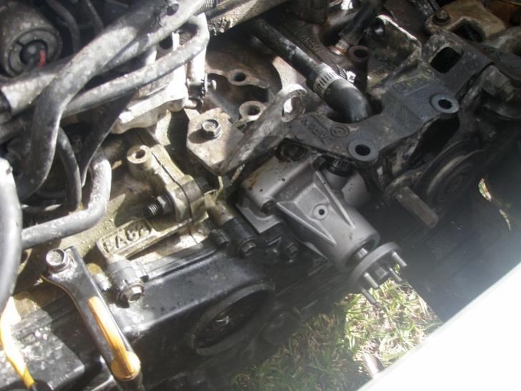

Post by openflame06 » Sun Jun 21, 2009 8:26 pm
Picture attached, new pump in.
