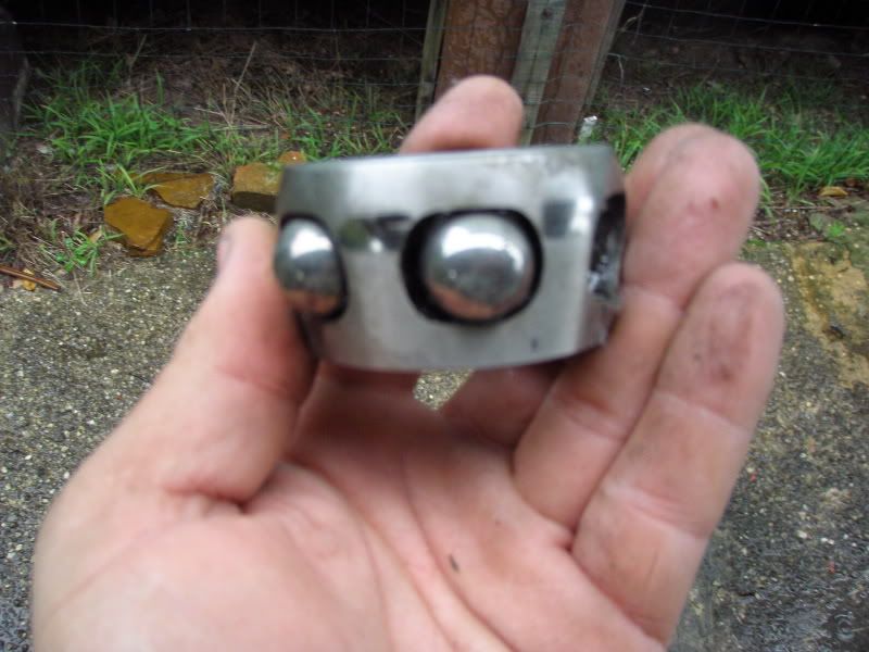

Then removed CV joint, stripped the inner DOJ and gave it a clean. There appears to be reasonable wear, hopefully the cause of the horrible clunking.

Post by justincase41 » Sat Apr 25, 2009 6:41 pm
Well well well, rule number one: Dont inspect your spigon bearing at 10pm in the dark and after consuming copious amounts of alcoholic beverages.
Got home from work, removed clutch and fly wheel and discovered that the spigot bearing is stuffed. Its a sealed beaing but appears to be very dry. Give it a spin and all you get it rumbling and heaps of movement.
I think I may have discovered the problem.
Thats why when the gearbox was reco'd, problem wasn't fixed. Old owner put new clutch in but didn't replace the spigot bearing or machine flywheel. Flywheel looks good but will take in to shop to get them to check it for warpage and runout just to be safe.
