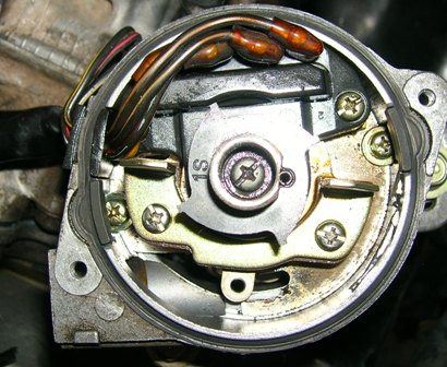

the guy is working on it now, but since mine was stuffed i really need a picture of the distributor with the cap off so we can see the no vacuum/no boost position of the advance/retard thingie's arm. just like the attached picture, but with the vacuum thingie in place and connected

anyone??? would be awesome to have the picture by tomorrow morning so the guys can get the thing fixed. once the guy has the placement on record, everyone can benefit!
Post by steptoe » Thu Mar 26, 2009 10:32 pm
Done
I emailed two pics separately to [email protected] at 11:30 PM Thu26/3/2009
hope they help

can you email them to me? [email protected] - apparently when i spoke to mike that email address isnt working at the moment
Post by steptoe » Fri Mar 27, 2009 12:57 pm
done at 1:55PM Friday

thanks jonno, everything done, $75 later.
looks great. told mike that there would probably be a fair few guys from here getting their diaphram rebuilt.
Post by steptoe » Sat Mar 28, 2009 3:48 am
so just what was done to rebuild the vacuum can that photos were needed?
Got a photo of finished product?
