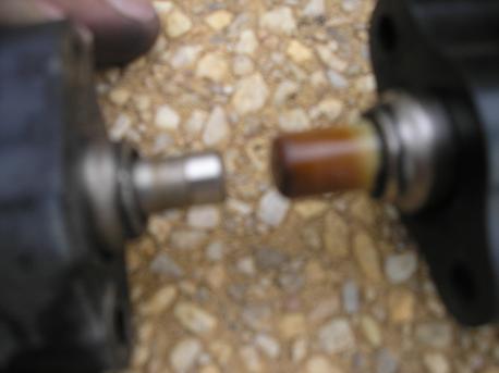

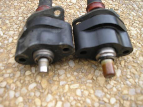

My cars been missing so i removed the injectors to clean them and i expected them to be the same.
Have a look at the pic these are from the LHS of a ea82T engine
One is disticively different as can be seen by the larger injector but the absence of a injector pin sticking out (in pic RHS one).
Is this normal can somebody please advise ASAP ASAP i would take the rhs ones out too to have a comparison but its a hard job.
I pulsed them with a 9v battery and both release fuel though the injector pin one seems to spray a little more.

Exactly the same injector
The only difference is the plastic cap off one is missing.

That would make sense, though a plastic cap? doesn't the heat from the combustion process damage the cap?

They just get brittle from age

:roll::roll:Looks like someones engine has sucked in a pintle cap:rolleyes:....
