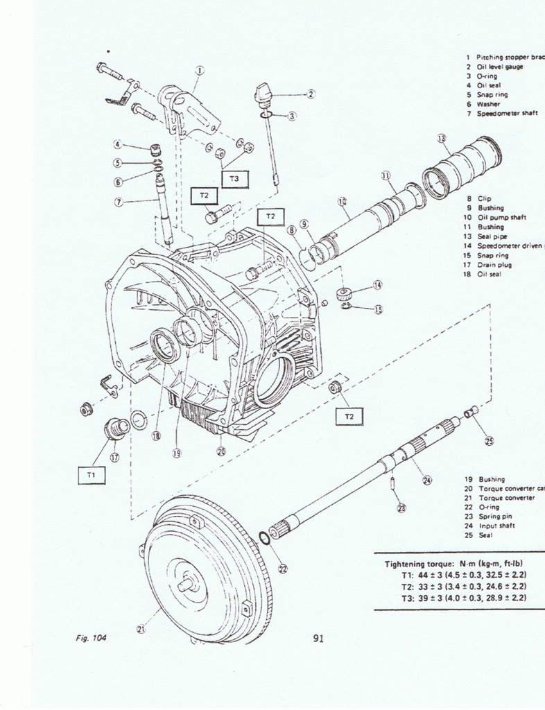

The imput shaft on the gearbox which the torque converter fits onto has pulled out when the engine was removed.
Problem is I can't push it back in, I have tried with rag and vise grips but no success.
Any ideas???

No problems with the oil pump shaft (tube thing that plugs into the converter) it is the centre spline (input shaft) that is pulled out approx 20mm.
Looking at the downloadable service manual it is true that there is a spring pin located through the shaft inside the box.
The drive shaft is hollow and I can see some thing that resembles a pin.
? Can this be rectified without a full Transmision teardown.

OK Sounds like I need to drop the box so that I can rotate it. I am unable to refit the shaft as it is now.

I took the gearbox to the transmision shop which reconditioned it and they removed the shaft and refitted it. I did not know that the shaft could be pulled out completely and was concerned I would damage it.
However it is all sorted now.
