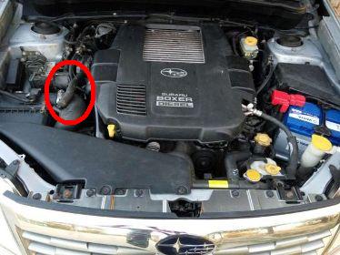

1) Good on you for catching the split in the pipe. Check all of 'em, elbows, hoses, pipes, joints for looseness etc. and replace where possible/necessary with silicone ones.

Thanks. We did repaired the turbo to intercooler one about 3 years ago. We cut the oil damaged section at the turbo and used a silicone hose over the top of the hard plastic section. We are servicing the car every 5k and fix/repair anything that doesn't look right as soon as we see them.pitrack_1 wrote:1) Good on you for catching the split in the pipe. Check all of 'em, elbows, hoses, pipes, joints for looseness etc. and replace where possible/necessary with silicone ones.

I did notice when the first intercooler pipe went a few years ago, that there was a lot of breathing going on. Appeared to coming from the small breather hose just after the air filter, so we made up the catch can trick for this and eveything has been clear since. I did clean out the compressor side of the turbo at the same time and I double checked it the other day went I replaced the second intercooler hose (the 70mm one), thinking it may have cause this problem (hose splitting) again but it is all clear still.pitrack_1 wrote:3) MRT has highlighted the variable turbo vanes can also get clagged and this affects their performance.

See what I mean about actual mechanical solutions?RSR 555 wrote:I did notice when the first intercooler pipe went a few years ago, that there was a lot of breathing going on. Appeared to coming from the small breather hose just after the air filter, so we made up the catch can trick for this and eveything has been clear since. I did clean out the compressor side of the turbo at the same time and I double checked it the other day went I replaced the second intercooler hose (the 70mm one), thinking it may have cause this problem (hose splitting) again but it is all clear still.

Ummm don't think that was the EGR hose that I used, pretty sure it's the crank case breather hose (see attached picture.. sorry not picture of actual car, as my daughter has it at her place) but I've circled the hose we attached a catch can to.pitrack_1 wrote:Yes it has been/can be done. I think you need to do it appropriately or you can get codes thrown. The EGR is water cooled and it may be that pipe you have catch-canned (not sure)?
- Breather Hose.JPG (25.76 KiB) Viewed 43614 times
Bummer, that!RSR 555 wrote:Hi Patrick, Well bad newsAccording to the scan tool, we have 170% soot level (really amazed at how we can get over 100% of anything these days???) and 30% blockage. Which won't allow us to do a force regen, so we are going to remove the DPF and have it sent away for cleaning.

No probs, likely I'm wrong (don't have the car myself anymore)!RSR 555 wrote:Ummm don't think that was the EGR hose that I used, pretty sure it's the crack case breather hose (see attached picture.. sorry not picture of actual car, as my daughter has it at her place) but I've circled the hose we attached a catch can to.
