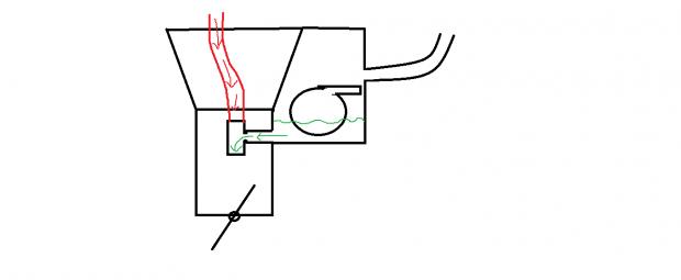

If your still running the hitachi double check the vacuum secondary opens freely. Id get a short piece of fuel line that fits onto the top of the venturi within the carby snugly and give it a blast with some compressed air. It should pull fuel thru the system and remove any crud thats built up inside the system.
I realise that probably makes little sense so here's a paint pic,
The red tube being the fuel hose you blow air down.
Short of pulling the carby down and cleaning it out its worked for me in the past. The other trick you can do is simply rev the motor up, then slap your hand over the top of the carby so it has to draw air thru the idle circuit, but it doesn't sound like you have an idle problem.
