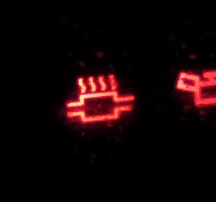

Okay so I recorded the dash this morning and the car "choked" around the 3rd corner. I have uploaded it here, http://www.youtube.com/watch?v=aXo10AF1 ... e=youtu.be . Sorry about the shocking recording, I was holding my phone with one hand while driving. Skip to the 2 minute mark to see the rpm drop as I try to accelerate out the corner. The car also struggled to start up as well. There is this light on the dash that flickers in sync with the ticking noise but I can't for the life of me find it on the internet. I think it may be an outdated temperature light of some sort.

I noticed in the video the same noise happens when you start the car and that light flashes briefly then the car starts (I downloaded the video :) ) I would think that this is related and could even be a faulty ignition relay. your other issue sounds like a faulty AICV.
It is hard to tell what that light is but if you have access to an owners manual for the 1993 LX it will be listed.

Here is a close up of the light that flickers.
[ATTACH]4131[/ATTACH]
Would I find information on the light in the LX manual or the the STI one? Because the car has an STI dash.

The light looks like cat over temp light, this might be a jdm cluster. I would post this up on RSLC and see what they say, lots of knowledge on conversions and early turbo subi s there. I'd guess ignition relay as well but check out with RSLC chaps.

Catalytic converter over temperature light. I'll look up how its wired and get back

Can you post some images of the engine and of any sensors in the up-pipe or down pipes?
This will give me an idea of what type of engine and wiring system you have
