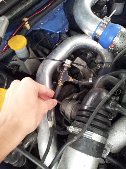

Can you upload a photo of the hoses that run from the top of the aluminium turbo outlet to the boost controller back to the wastegate actuator on the top of the turbo

Ah thats a manual boost controller. Where does that pipe go from the left side of that y splitter?

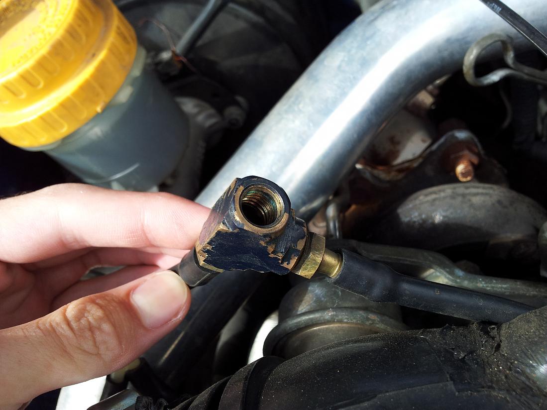

Definitely a MBC and looking at it, it appears it's wound most of the way out. I'd say your best to get a Electronic Boost Controller (or put back to standard) and have it turned correctly.

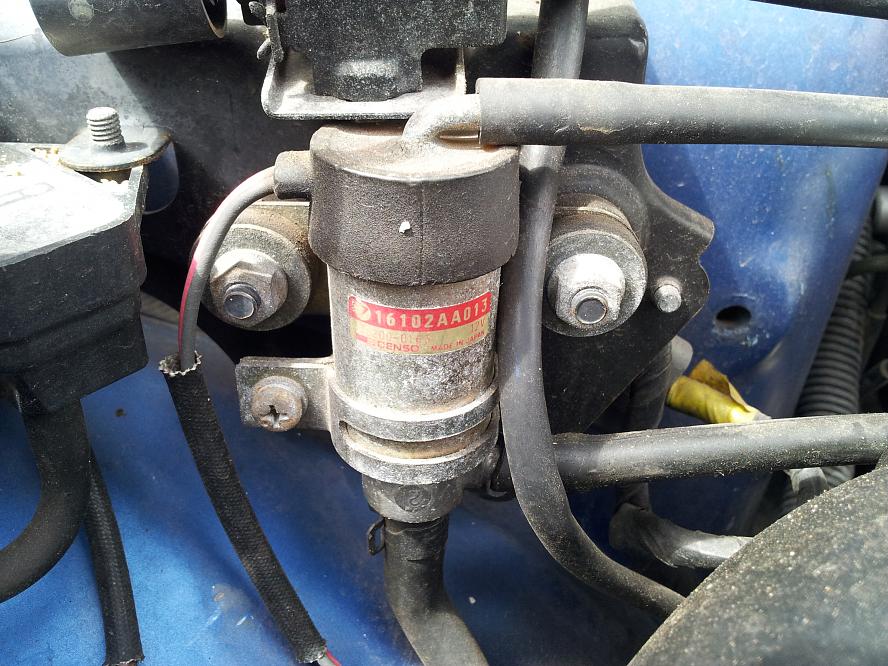

The tube traveling left of the y-splitter enters the top of this little cylinder shape thing. The tube coming out the bottom of the cylinder travels to a dead end and the tube coming out the bottom right travels to the manifold.
[ATTACH]4029[/ATTACH]
When I looked at the boost controller this morning, I noticed that the screw/bolt is not there. It must have fallen off while driving or in the engine bay somewhere because I can't find it on the ground anywhere. The screw must have been at it's limit and a small vibration would have loosened it off. Is this dangerous?
[ATTACH]4030[/ATTACH]

It can be very bad as you'll end up putting too much boost into the engine, thus increasing the chances of blowing it up. I'd go up to Japanese Wholesale and talk to Fats and ask him if he has the stuff to take it all back to standard.
You can start from there and do mods but as long as you have a reference point, you know what you can go back to if things don't work.
