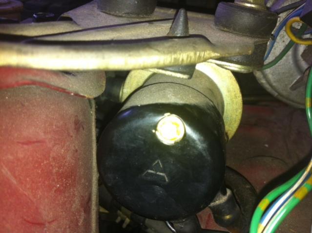

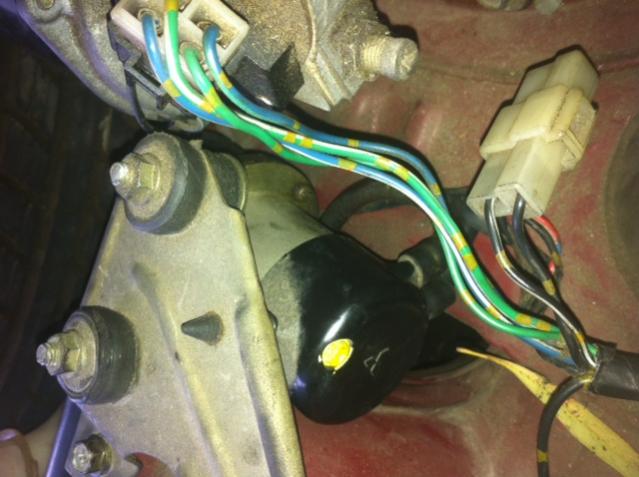

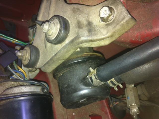

Hey,
I'm having dramas with my wagon of what I think are the fuel variety.
After driving if the car is switched off, fuel seems to drain away from the carbie and the car wont start for a bit.. after pulling off lines from what I thought was the vapour separator and putt them back on sometimes the car would start and run again with no problems. Below is a pic of what I was pulling lines off - I now think this is the fuel pump, anyone car to fill me in?
[ATTACH]3677[/ATTACH]
[ATTACH]3678[/ATTACH]
[ATTACH]3679[/ATTACH]
This component definitely makes pumping sounds...

That is the fuel pump, when you turn the ignition on, it should prime until the needle and seat closes, then the pump will stop. Thats what every MY wagon I ever owned did :)

Right, I'm almost sure that the pump is failing, not pumping fuel to carbie...
Unplugging and replugging the power supply to the pump got the unit to make pump like noises and vibrate, but only for a second.
Has anyone got any tips on where to get a new pump? Is there a generic pump that I could replace this one with>?
