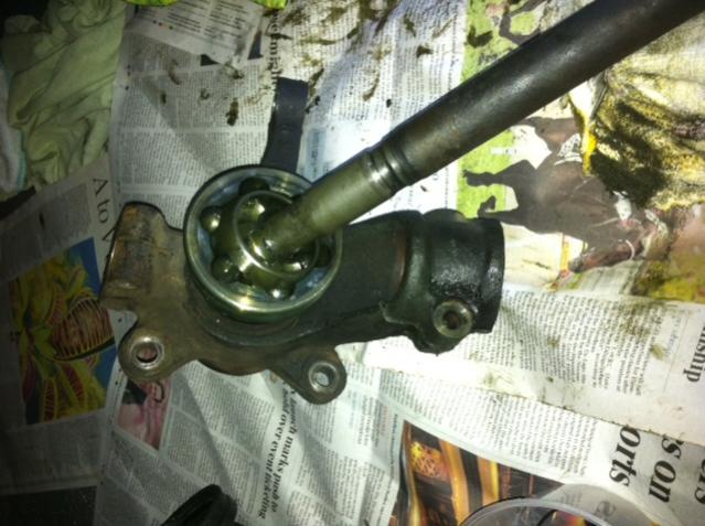

I have the RH Axel out still attached to the steering knuckle. Joints cleaned ready for grease and new boots (install tomorrow)

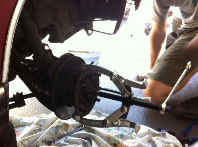

First time with a puller.. crazy things! the rotor literally jumped off I was scared shitless. haha.

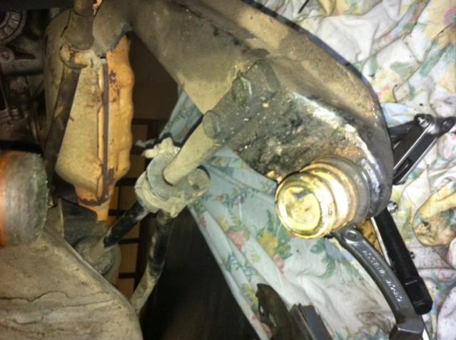

I have a question in regard to the ball joint that sits in the knuckle - It came out and was covered (lightly) in sort of powdery rust - as if it was dry the photo below is poor but shows it a little. Is there some specific lubrication/oil/grease that goes on this peice?

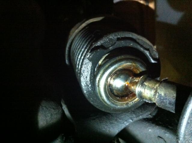

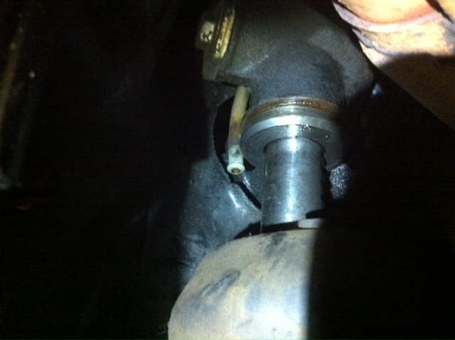

Also I managed to get a better look at the torn power steering boot while everything was off. (pics below) what are your thoughts on the liquid coming out? Haha. Im going to get some stop leak but any prognosis is welcome. And yeah confirmed for myself that I do need the boot with the breather.

Could I press this out using the puller?RSR 555 wrote:
then let the drive shaft drop and knock the ball joint/s back in (no real need to put the bolt back in at this stage) and using a brass drift (or similar) knock the outer CV Joint through the stub axle. I use a drift with a fairly point end so it stays central to the shaft and away from damaging the thread.
