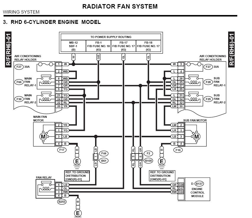

There are 2 fans, the main fan and the sub fan, each fan can operate at 3 speeds.
When the engine reaches about 97deg C, one fans kicks in in low speed with the air con off, if the air con is on, it bumps both of them up to mid speed, if the engine reaches 98 with the air con off, it runs them at middle speed. If the engine reaches 98deg with the air con on, it runs them at high speed.
Here is a diagram
Here is a diagram
- Radiator fan 03 H6.JPG (93.68 KiB) Viewed 3660 times

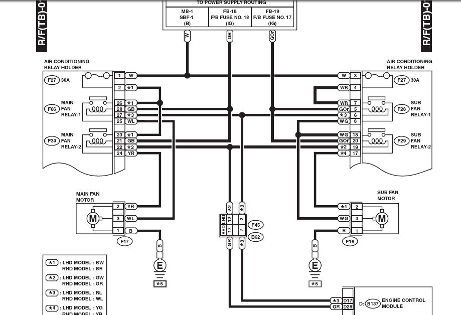

No its not, the the 2.5L ECU chooses whether to run one fan on high, both fans on low or both fans on high, depending on engine temp and air con status. There is NO fan dedicated to just air con in either model.Davidov wrote:LH fan is for the AC. It is like that in my Gen 3 (only 2.5L but i believe its the same).
This image is of the 2.5L radiator fan system, it does not apply to the original post
- 2 wire fans.JPG (76.7 KiB) Viewed 3658 times

Ah ok, i don't think ive ever seen my LH fan run, and was told by others. My bad.Gannon wrote:No its not, the the 2.5L ECU chooses whether to run one fan on high, both fans on low or both fans on high, depending on engine temp and air con status. There is NO fan dedicated to just air con in either model.
