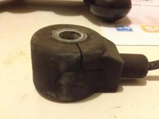

and alex your right on the money, the only code it is throwing is 22 or other wise known as KNOCK SENSOR. i have another one on the ej25 i might swap them over tomorrow.

heres a picture, looks like it could be faulty LOL
Post by Alex » Wed Apr 11, 2012 8:10 pm
Yeah that's Sooo common

Well I put a good looking knock sensor on and the same thing happened.

ok i've got a new knock sensor ($66 genuine), still havent cleared the code yet.

knock sensor code is GONE
