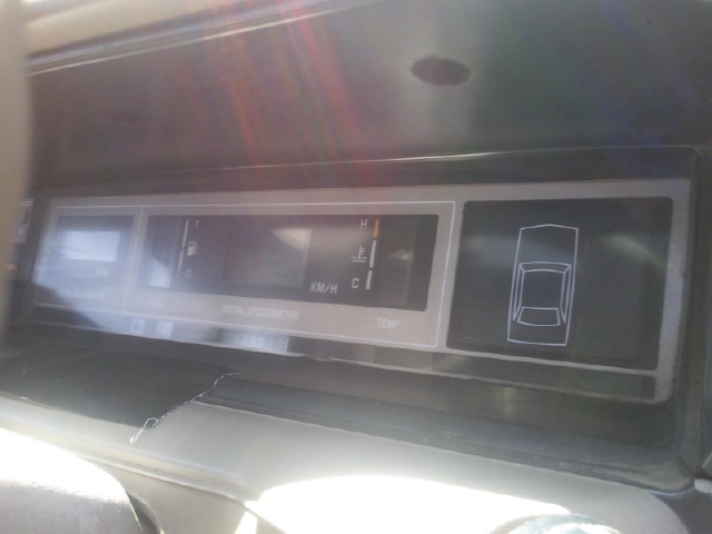

Heres a photo, pretty crap from my phone, but you can sorta see what its like, and If you've had a car with this dash even better :0.
Excuse the Duct tape to, only temp to hold my gps.
I was pretty shocked when I saw this, for a 1982 car, it seems pretty high tech.

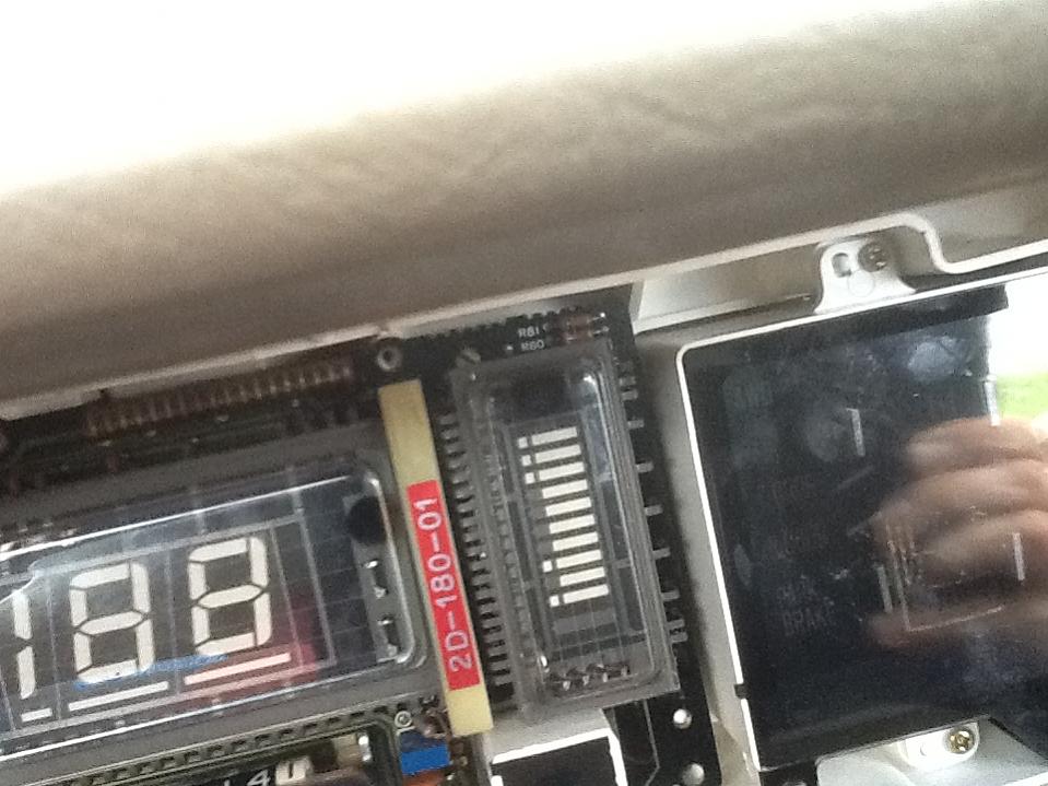

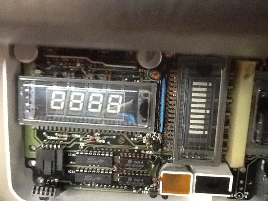

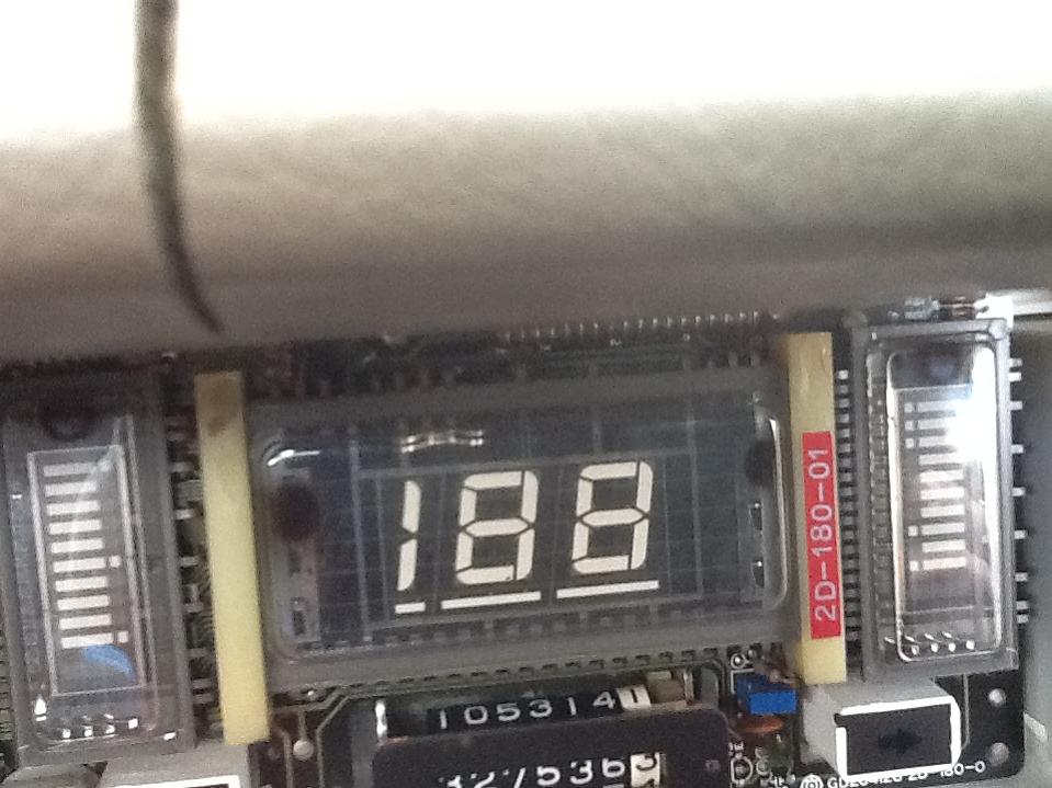

Here ya have it fellas, the goodies, so to speak. Im thinking those black spots are custom. Also, if you look at the top left of the PCB, theres the main reg for the whole show. It looks fried so Im hoping its what has failed, and the spots are hopefully where those little fuses have gone off.
Whatda think, Fixable. Im gonna do some probing but first Im gonna cook some food, Be Back later.
Doug
EDIT: Not the voltage reg, He's pumping out a solid 5v, hmm. Can you get new dash modules like this?

Ok.. the black marks are normal and just age burns, nothing to worry about.Subydoug wrote:Here ya have it fellas, the goodies, so to speak. Im thinking those black spots are custom. Also, if you look at the top left of the PCB, theres the main reg for the whole show. It looks fried so Im hoping its what has failed, and the spots are hopefully where those little fuses have gone off.

Oh and also it appears that you have removed the main cover section to the cluster. Personally I would have removed the complete unit. This would help with checking the PCB fuses, as these are on the back of the unit.
5V is good.. so seems unit is getting powered. I would follow along the board and see if something jumps out.
