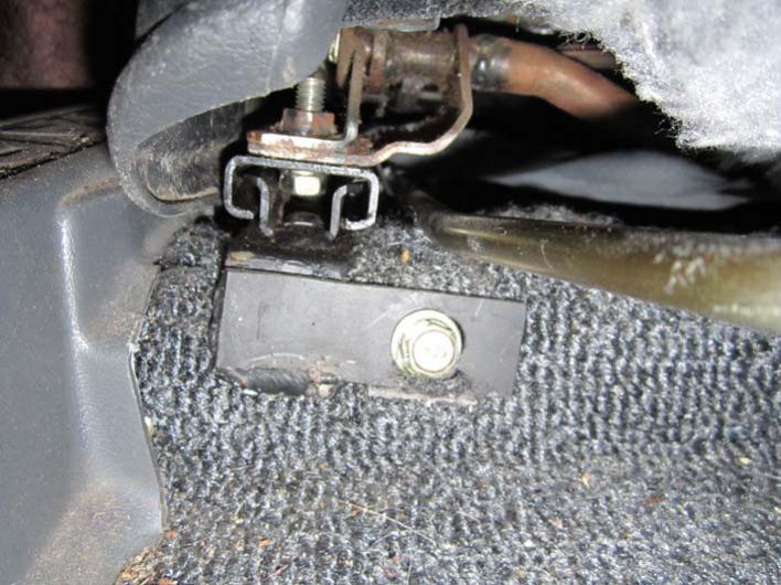

Just did to my Brumby. I got the Liberty seats from Guyph.
Take the rails off the lib seats and bolt on the Brumby rails. They virtually bolt straight on. The rails near the drive train tunnel fit without and mods. It's the outside rails that need the mods to fit the holes.
The lib seats are about 70mm wider than the brumby.
Put the seats in the car and bolt up the tunnel side.
You will see how far the rail is away from the hole in the floor pan.
I cut some 4mm thick metal about 70mm long and 25mm wide and welded it to the rail so it extends back to where the floor holes are. Drill a hole about 3mm larger than you need to allow and play.
Do this to the back hole as well.
Here is a pic of the bolt.
