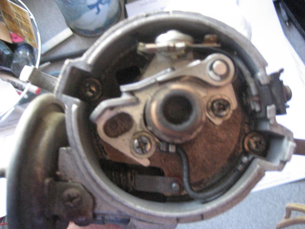

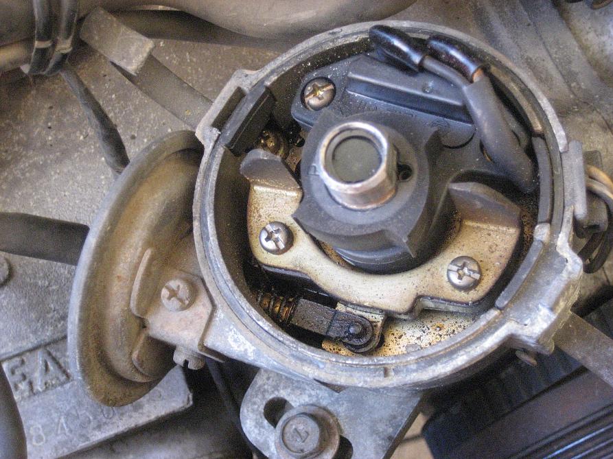

Steptoe, I don't know what ACA Branded parts means. However I have all the particulars off the two Distributors. The first, the one I purchased from the Wrecker, I think is a Nippondenso and has the following numbers stamped on the side 429878602, and under that D4J80-02 2Y05. The other Distributor, still in the brumby has the following stamped on it, D4R88-01, and under that 22 100 AA480, and under that, 8204. This is the Distributor that does not appear to have contact points. The reason that I purchased another Distributor is that some peanut, I won't disclose where this peanut is, informed me that all brumbys came with contact points as standard. I was in the process of upgrading the Distributor to Electronic, but it would apear that I have already have an Electronic Distributor. So much for taking other peoples advice. I have attached photos of both Distributors. The Distributor that I have in my Brumby looks identical to that in El Freddo's. Just tried to attached photos without any luck will try later.

Post by Buddyboy » Fri Jan 20, 2012 5:50 pm
[attach][attach]3107[/attach]
[attach]3108[/attach][/attach]
Guys,
Top photo is the Dizzy from the wreckers and the other photo is what is in the Brumby now
Buddyboy
Dizzy in Brumby.jpg (115.71 KiB) Viewed 7305 times
Dizzy from Wreckers.jpg (120.95 KiB) Viewed 7305 times

Post by steptoe » Sat Jan 21, 2012 8:13 am
I'd be getting some help from FROG to identify the part number for 89 dizzy, and if it is not the same as the points dizzy you bought should be entitled to a refund from the wrecker - certain the 89 Brumby they have must have had an early dizzy swapped into it.
You have electronic dizzy in it already !
