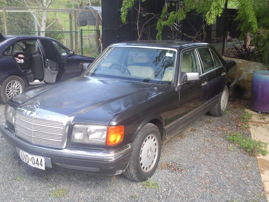

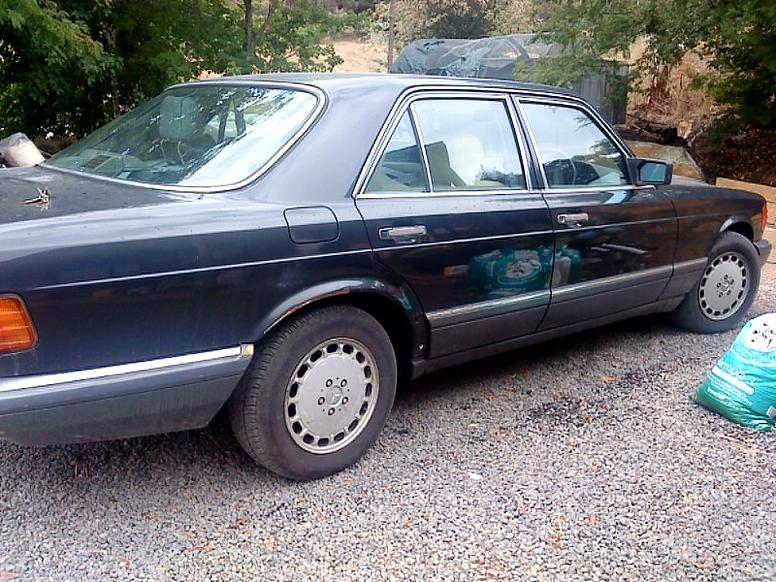

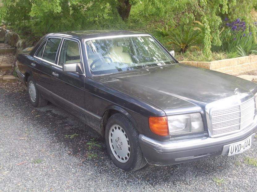

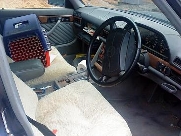

What model is the benz? Pics?

its a 91 W126 300SE
