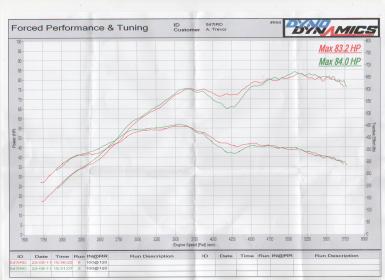

Well, the car has finally come out of a tune thanks to 6boost, Toowoomba, much appreciated. The flat spot appears to be gone, performance is good but having had the trouble for so long I thought I may get more grunt out of it.
The car wouldn't start after the tune and as we had been having a little muck about with it beforehand, apparently my son (the 13B rotor nut) left the check box for the TPS highlighted. Anyway, the guy turned the TPS completely off and the car just runs off the MAP sensor (Vacuum) apparently. With the five speed box, you have to drive it, but its a fun drive.
Jamie (The mechanic) said it was showing the flat spot on the tune so he's fixed that, don't know why it was there. I went for a canter around Toowoomba after it came off the dyno and it was ok, 100% better than it was, because it had a real hesitation before.
We then flew down the Toowoomba range and back up and its performance was pretty well as before without the hesitation it had beforehand.
Not big horsepower but fun to drive...Dyno readout below.
[ATTACH]2898[/ATTACH]

A while in the making and good end result. A bonus that you got someone local to tune it. So the MAP sensor takes place of both TPS and AFM with your ECU eh?
You really can't expect too much from it power wise as the 6 or 7 psi boost is working on a 7.7:1 comp ratio and is really only a bit of an improve over the carby EA82 or about 9.2:1 so first few pounds of boost are really only catch up.

Yes, he thought that there was something weird with the TPS and it just wouldn't start while it was activated. He said you would need the TPS for tuning for deceleration ????? but in effect this ecu just uses the vacuum to give the engine the info it needs (MAP). I have a suspicion that the ecu may have had a hand held unit attached before I bought it and some of the tuning has been interferred with in that way. The lead for it was still hotwired under the dash and I took it out some time ago when I cleaned up some of the wiring there. Incidently, there was a turbosmart boost controller fitted when I got it but I removed it when trying to sort this stuff out., I read an early post on here regarding these on an ea82T and the advice was not to submit these engines to too much boost. What do you think Steptoe?? Refit the boost controller or leave it?? its showing about 7lbs at the moment.
