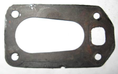

Post by olddog642 » Thu Mar 31, 2011 10:52 pm
Just as an afterthought most good carby places will have the gaskets for
the base and the body in stock about $5 each
They look like this
(img) IMG_2566.JPG (22.9 KB)(/img)
Hylton:twisted:
