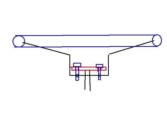

there should be 2 holes either side of the center bolt, get a piece of flat bar & drill holes the same distance apart then get 2 bolts 12 or 14mm & wind them in a bit at a time & it'll pop off.
Excuse the crude drawing
