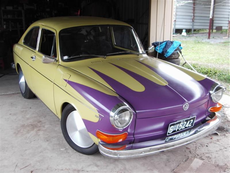

Post by freakazoid » Fri Nov 19, 2010 5:30 pm
yeah its a "festy", lol, currently running an ea81 and auto, its a nice cruiser, Not quick but heaps better than when it was dub powered.
Post by RSR 555 » Fri Nov 19, 2010 6:39 pm
freakazoid wrote:yeah its a "festy", lol, currently running an ea81 and auto, its a nice cruiser, Not quick but heaps better than when it was dub powered.
Pics ;)

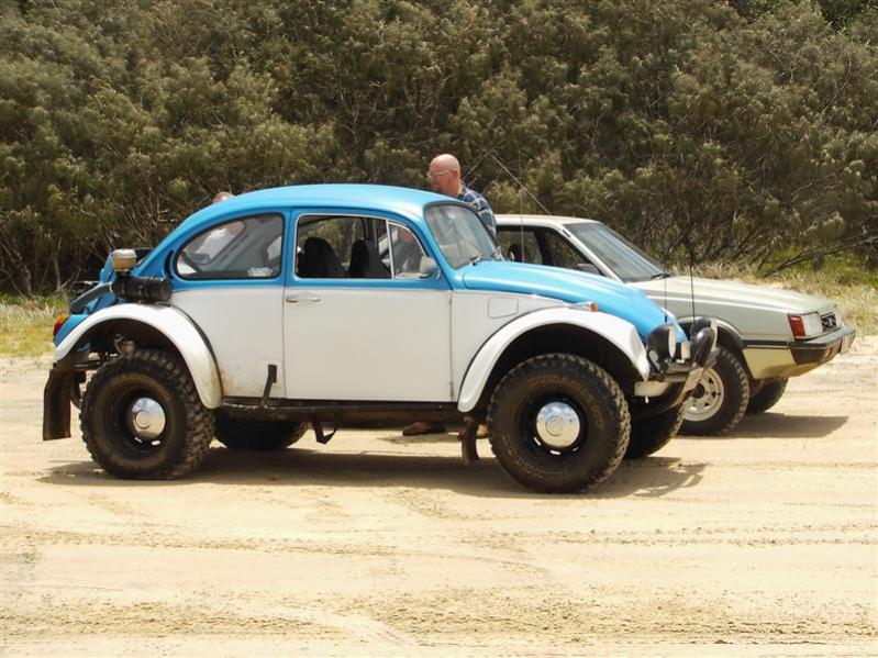

Post by freakazoid » Sun Nov 21, 2010 7:18 pm
Heres one. It gets used all the time just a real nice driver.:grin:

Post by freakazoid » Mon Nov 22, 2010 6:46 pm
Thanks, This is the baja we just put the ej22 into with my L series sedan behind it.
PIC03638 (Medium).jpg (88.96 KiB) Viewed 5525 times
Post by RSR 555 » Mon Nov 22, 2010 8:54 pm
freakazoid wrote:Thanks, This is the baja we just put the ej22 into with my L series sedan behind it.
I bet she goes a bit better now :p
