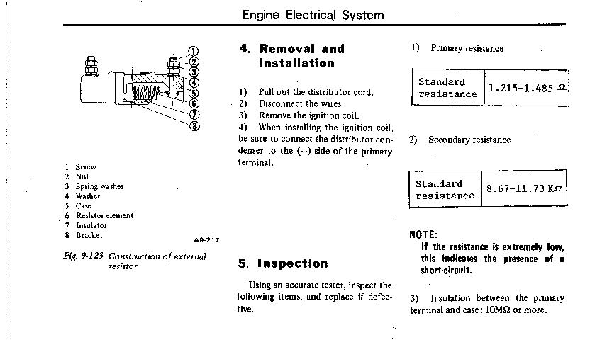

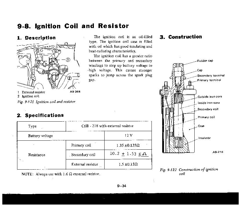

Post by olddog642 » Mon Aug 16, 2010 8:52 pm
Don't know if this is of any use to you but it is from my manual which does cover both 1600 and 1800 engines.The coil being a Diamond Electric model # E-001-02-R
Hylton:twisted:

Post by Pootcrum » Mon Aug 16, 2010 9:10 pm
Thanks Hylton, it is useful to know.
The setup described in your manual appears to be different to my setup, mainly the ballast resistor (and hence the different coils). But still, the values you have posted aren't too dissimilar from my measured values. Maybe I need to start looking elsewhere for my power problem.

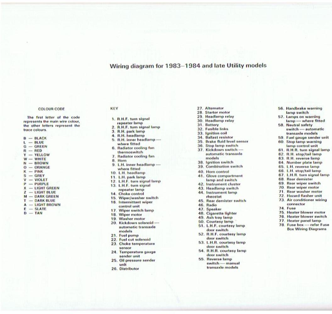

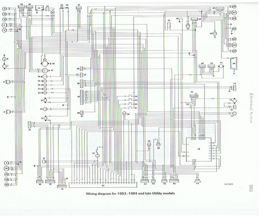

Post by olddog642 » Mon Aug 16, 2010 11:50 pm
G'day
just some troubleshooting pointers and a wiring diagram
:twisted:
