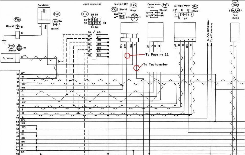

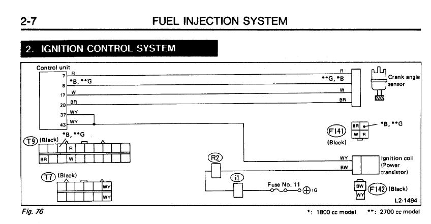

Post by Gannon » Mon Jan 11, 2010 7:33 pm
Are you testing it at the coil or the power transistor?
Here are some diagrams
Try testing the black/white wire at the T shaped plug?
88 Mpfi Wiring.jpg (108.91 KiB) Viewed 5308 times
Coil diagram.JPG (50.3 KiB) Viewed 5307 times

cheers mate thanks for that diagram
i have tested both pos and nev on the coil than tested the plug from the harness

Post by Gannon » Mon Jan 11, 2010 10:55 pm
Did you test the T shaped plug that plugs into the Ignitor Transistor?
Maybe you have a dud transistor
