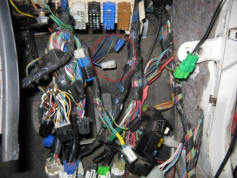

For the ECU to get the A/C on signal, I need to check where the "dealer fit" Oz A/C loom connects (if at all).
The only thing I can guess is that up behind the fusebox there is a pair of blue/yellow wires into a single pin plug.
This is a matching plug to one on the A/C loom in a similar position (Blue wire which I know is the A/C on signal from the switch).
Am I correct in thinking that these plug together?

Is this the plug you're talking about, Suparoo (see attached)?
White one is the A/C loom & blue one is the car.
They seemed way to close to be just convenient.
And the A/C loom is desgined for both RHD & LHD, so there was another plug in a similar position on the left side.

Blue wire? i think thats it. Its been a few years since i did mine but it looks right.
Its been a while since i have seen you on here Wagonist. I thought you abandoned your 88 WRX touring wagon project. Good to see you back.
The wire's in too convenient a spot to not be it.

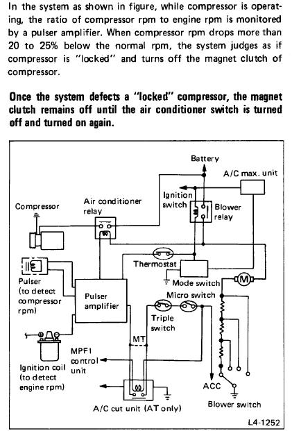

The MPFI engines throttlebody has a solenoid valve called FICD which I think means fast idle control device . This is separate from the idle speed by pass screw and passage but the FICD also has an adjustment screw and its own passage .
From my 87 WSM it simply says it switches when the blower fan and compressor are selected .
In the wiring diagram it is linked to the Rad Fan Relay and the Air Conditioner Relay and I think via earth switching of the Blower Fan Relay .

Next question:
tacho signal for the A/C, where does this come from?
On the carby versions, and the series 1 EFI's, there's an extra wire haning off the coil, but it seems that the later EFI's get there tacho signal from the distributor (ie cam sensor).
On the car I stripped the loom out of, I didn't notice a wire for the A/C hanging off the coil.
Doesn't mean I can't do this though;)

It shouldnt matter what model, they all should work the same way
Im assuming you are refering to the yellow wire that goes from the negative side of the coil, to the pulse amplifier
- air con.JPG (58.68 KiB) Viewed 3526 times
Yeah, that's the one, basically the tacho signal.
I'll just retrofit something. Ain't hard.
Just discovering how much Subaru changed for the series 2. ie tacho signal comes through the driver's side of the dash. Which really fun when changing the loom over onto the black series 1 skin & discovering someone had chopped off the headlight wires plug:mad: Lucky I had trhe original carby dash loom still to massacre.
