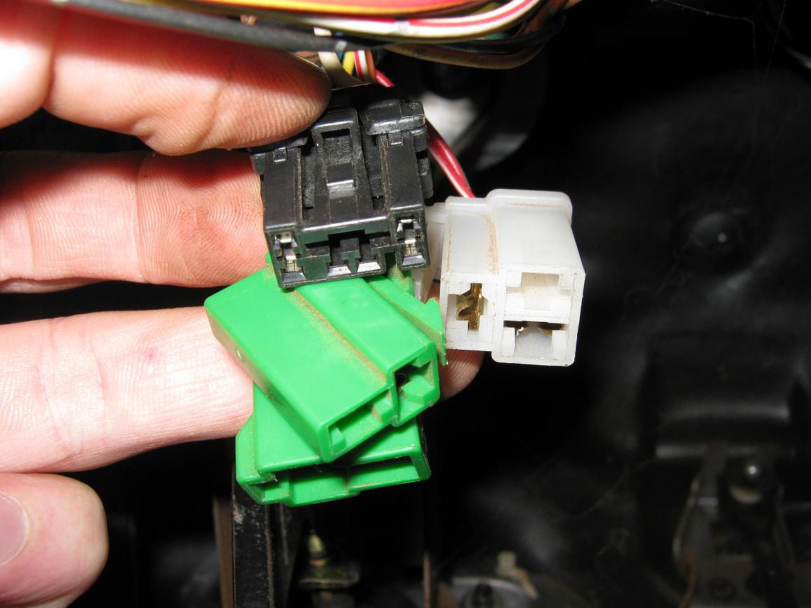

Didn't even think of the fault codes, these modern cars are all new to me! From what you're saying, the knock sensor could be the culprit.
I went to check the ECU codes, only to find that the black/white plugs are not compatible. Any idea how to check the codes...see attached picture.

Half the time you'll find dead O2sensor but the error code doesn't show because ECM thinks its okay.Jeff wrote:What fuel are you using? And if you suspect a faulty o2 sensor check your codes.
Try finding the plugs possibly still have tape on them somewhere attached to the loom under there.. have another look...QikRX wrote:Only run 98 ron fuel, still with the same result. All fluids are fresh (2000km's) and at the correct level.

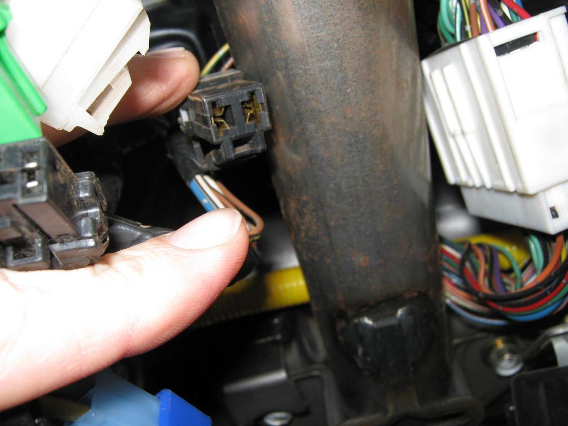

Found another black plug, so thats 5 in total. Only issue is that it's yet a different type to all the others!
There appears to be no other plugs that aren't already plugged in...got right up in there this time.
Here's the 5th which was up higher.

After been thinking about the "plugs" I think this forester requires OBDII scan tool to check the codes... Most mechanics have them so worthwhile checking out for you.
