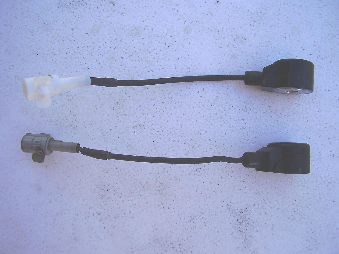

Haynes manual says no continuity in EJ22 Knock sensor but mine has 550 000 ohm resistance.
Can someone test their sensor?
I have a knock sensor fault code. Is it a fault in sensor or wiring? Engine running smooth

Post by iananita » Mon May 04, 2009 6:48 pm
Was getting intermittent knock sensor fault code. Here is the reason. Old sensor(at bottom) had cracked casing. New sensor now in no fault codes.

Post by AlpineRaven » Mon May 04, 2009 9:07 pm
If you're still getting no replies, i'll check mine, i have a spare one in the garage.
tex
Posts: 553
Location: OUTSIDE Canberra!
Post by tex » Mon May 04, 2009 9:10 pm
Seems to be a common problem and as someone pointed out to me the positioning for them isn't exactly the best! I went through a subaru wrecking yard and couldn't find one that hadn't cracked from the heat!

Post by vincentvega » Mon May 04, 2009 9:27 pm
this is one part you really shoud replace with a new one.
Take the thing out, if there is any signa t all of cracking it needs to go in the bin.
$140 from subaru. will solve your problem

Post by Joel » Tue May 05, 2009 10:21 pm
i have heard of people relocating them
checked mine and ofcoarse.....cracked.....:rolleyes:

Post by Talasas » Sun May 29, 2011 4:31 pm
For the record the Gregory's manual says that they are supposed to have 560k ohm resistance. But they are notorious for cracking, replacing it was a good idea.
