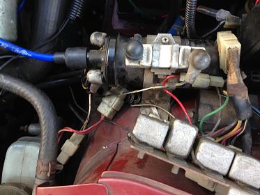

[ATTACH]4087[/ATTACH]
Mounted on coil - Is this the resistor?

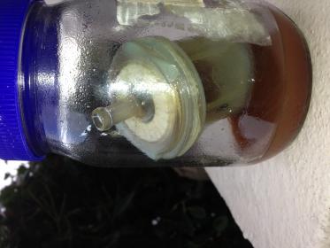

[INDENT]Checked fuel filter - full of filthy sediment red in colour - changed fuel filter to a repco filter, drained fuel from carbie back.

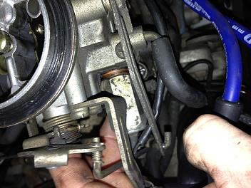

That evening got a little wild with the carbie cleaner figuring my problem could be some kind of dirty carbie/crap in fuel issue (considering state of fuel filter) I didn't run the car for long after all this cabbie cleaner

Might have to pop out the fuel tank and make sure it aint rusted out. Rust in the filters can indicate that. Question, does the car stall for measurable durations, like 10s, or is it more like a savage miss? Does the engine sould lean at idle? Rich at idle? When the engine is running, if you get a hose and gently squirt water around the base of the carby and where the carby bolts to the manifold, it will stumble if there is a vac leak (only very little water is needed)
Yes the white thing on the coil is the ballast resistor. If your digital multimeter does capasity, make sure that the caps on the coil and at the distributor are ok. If they are damaged it can cause flakey spark from arking at the points. Also leads to premature failure of the points.

Right back in archives you will find more than one has fixed a similar problem by removing all filters and pump from fuel lines and blow compresed air from front in engine bay to where fuel pump hooks up, then from fuel pump line to tank. Ensure tank is empty so you can pull sender off and scrape out the crud from rusty insides of fuel line :D
Think mine was sold due to previous owners attempts to pay qualifieds to sort it :D
Then I come along, plugs, leads coil, filters, carby kit, fuel pump then the resounding THOONK of crud landing on the floor of inside the tank :)
