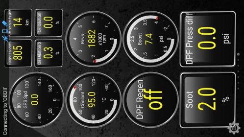

Up and running :) many thanks. There was a few things that stumped me but we were able to work through them. I've setup one of my old mobile android phones for Danielle to use and leave in the car.
I will list some of the issues I found.
1. You (anyone else wishing to install) need to make sure your android device is connected (and has the capability) to the net
2. The OBDII dongle is a good quality one (I brought one from Jaycar because the ebay one I brought stopped working)
3. I had to create the subdirectory folder for the PIDs, as there was nothing in there for the file you sent me.
4. The dash layout was over 4 pages and some were different to the ones on the display I posted.
We went for a test drive in our Outback first and was very pleased with it. Our Outback is Diesel with CVT, so I was wondering how it would go with holding the right RPM but it did with ease and was good to watch the whole process.
I'll attach the dashboard I've setup on my old phone for Danielle to leave setup in her car.
Danielle dash.JPG (30.77 KiB) Viewed 56352 times

RSR 555 wrote:I'll attach the dashboard I've setup on my old phone for Danielle to leave setup in her car.
Nicely done, nice and simple.

pitrack_1 wrote:Nicely done, nice and simple.
Yeah, just on the front screen for Danielle, the other pages have all the other stuff.

RSR 555 wrote:Yeah, I can understand loss of bluetooth comms could cause an issue but it our case, we are leaving the dongle and android device in the car all the time and never removed (hence using an old phone that never gets used anymore).
If you're not having any problems, I wouldn't change anything.
Patrick
Ex- 2010 Forester Diesel
Post by RSR 555 » Mon Apr 30, 2018 12:00 pm
pitrack_1 wrote:For example: I'd totally forgotten I must've created the PID subdirectory myself. Or perhaps adding them manually in the program (which you can do, it's in the preferences) created it...although now I come to think of it that may be the case because I think that's where I got the csv file structure from too to manually type up the PIDs and put them in the directory.
Thinking the same here too...
I did buy a new (4 inch screen) phone from BigW the other day and removed all the unwanted installs and rubbish stuff on the phone, then installed Torque Pro and Ghost Commander. I then went in to Torque Pro and openned up settings and clicked on manage PIDs, which was empty at this stage. I then clicked add predefined set and saw other other manufacture's cars but of course the Forester ones weren't there YET. I then closed out of everything and went ahead with the transfer of files via Ghost Commander.. and guess what.. there was the folder for PIDs :) So I'm thinking it might be easier to put this in the install process than what I did (creating folders) on my tablet.
Post by RSR 555 » Mon Apr 30, 2018 12:29 pm
pitrack_1 wrote:In case you get the Christmas Lights;
- Pull over safely (if somehow whilst driving).
- Power off vehicle.
- Exit Torque.
- Vehicle ignition on (no need to start).
- Start Torque.
- Select fault codes from main Torque menu.
- Tap to scan for faults.
- Confirm only fault is CANBus error (otherwise there are other issues).
- Select Clear Faults from ECU from top-right menu, you may need to do this a couple of times.
- Exit torque.
- Start vehicle and confirm Christmas lights (and any others not normally on) are gone.
Well it happened.. not the full christmas tree lights I was expecting but 5 or 6 warning lights appeared. Shut the engine down and checked for codes. U0073 (communication error) was the only code, so cleared with scantool and restarted engine, all good. Made it clear to Danielle that she needs to exit out of Torque Pro not just swipe it, which she assumed it would shut it down but obviously some things were still running in the background.
pitrack_1 wrote:Note leaving the dongle in the vehicle has been known to drain the battery as the OBD port remains powered. Also someone else could conceivably come along and perhaps connect to or hack into it...
We have left our Jaycar OBDII dongle in and had no experience of battery drainage but I would think that any draw these units would be able to pull out of the OBD port would be very minamal due to the size of wiring (in the car) and the construction of the electronics inside the dongle. I feel anyone having troubles with power loss, are having issues elsewhere and the dongle is highlighting it.
Thinking about this issue of someone coming along and 'hack into it' has me worried but what I'd found so far with bluetooth devices, is once one device is connected (and stays within range) then no other bluetooth device can... or is this wrong?
