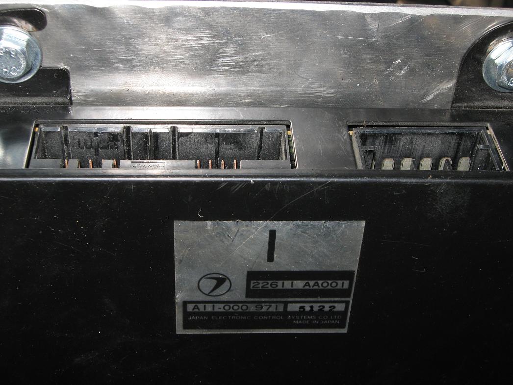

photos of plugs on motor
- wires to dis, coil, knock sensor.jpg (114.2 KiB) Viewed 10047 times
- wires out of motor main loom.jpg (112.88 KiB) Viewed 10046 times
- multi point injection ea82t i think.jpg (116.52 KiB) Viewed 10047 times
- Computer.jpg (114.89 KiB) Viewed 10048 times
- air flow meter.jpg (102.04 KiB) Viewed 10048 times

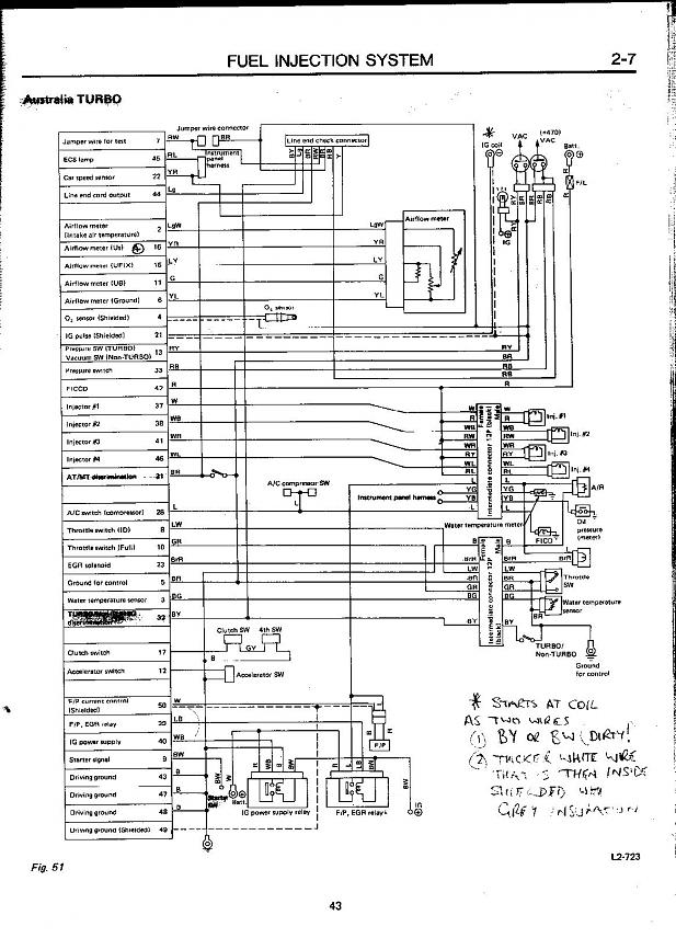

just traced the wires on the pin out you wrote up, quite a few differences to the one i have
firstly when it comes to wire color where you written L my wires are BLUE?
pin
04 has a yellow wire
18 has no wire
19 has no wire
20 has white(sheilded) wire
21 has no wire
22 has yellow wire with blue trace not yellow red
25 has no wire
30 has no wire
31 has blue green not BR as stated
49 has black wire
50 has blue red not white
havent found a diagram or pin out that suits this yet i am still looking, maybe this is new zealand omega wiring different from Oz?

L is blue
So for example
YL is Yellow with a Blue trace.
LG is Blue with a Green trace.
Trace is the thin line of colour on a wire

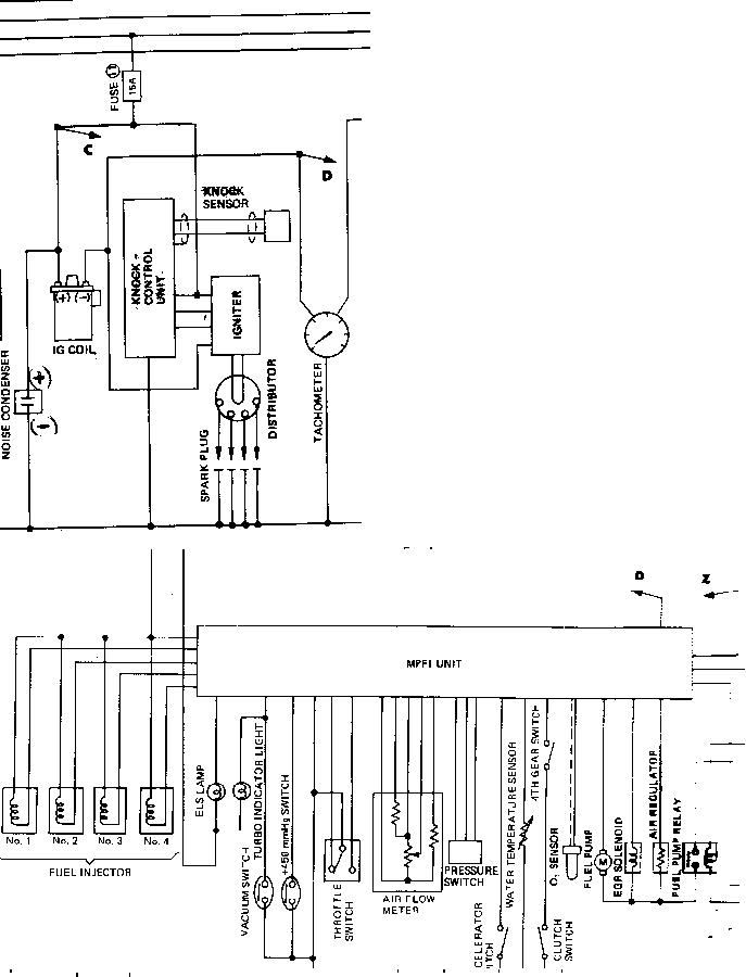

Ignition pulse should be pin 21 (no colour shown) but from memory it is a shielded. This wire also feeds the tachometer.
It comes from the negative side of the coil and is also connected to the ignitor unit in the distributor shown as 'D' in the first image

is ignition pulse wire connected to neg side of coil?
you may ned to find a check connector that has nothing plugged into it, may be close to ecu in wiring loom is a 3x 3, three rows of three wires
the test wire for ig pulse is either a BY shielded at 0X0 of the top row, or Y shielded X00 of the bottom row.
if your pulse wire is connected to coil neg, with ign on , check between the wire X above and the BR wire ecu ground control ...if you get 12v says to replace ecu
well thank to you guys we now have injection pluse! was a stupid white wire in the standard black sheild tucked inside the loom we thought we had traced twice already but we obviously overlooked it, dork! haha
but reasonably confident the wiring is ok now just have to try time the dizzy again as we cant start it up haha
thanks alot its been a great help picking the brains of all you guys ha cheers!:o

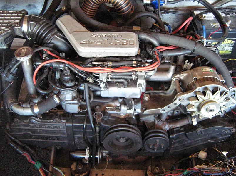

how did my crank case fill up with water!! so full it came out oil filler hhaha not ideal . is this a blown head gasket or intake manifold gasket?
had garden hose hooked up through were radiator wolud go while engine was running in my boat and am gessing pressure was to much and blew gasket even though tap was only just cracked open.
internet tel me it could be intake but i dont see how it gets into crank case...
please help haha
please help haha
Yeah it seems a lot more like a head gasket, i can't imagine water getting past the pistons without causing hydro lock.
welch plug, welch plug, welch plug - pull a rocker cover off either side and there is three in the EA82 heads ? same count as EA81 , little buggers are 20mm in EA81, think it is same in EA82. The manifolds also have 10 or 12mm ones at the back that can leak outside the block. On a boat you are not gonna get tell tale drips giving the game away something is amiss. You will need somthing like a watchdog TM2 or TM4 .
Here is a link to a pic with water sitting at welch plug
showthread.php?t=20056&highlight=welch+plug
These little known plus are most likely your culprit. I didn't even know they existed till jono brought them to our attention in that thread.
