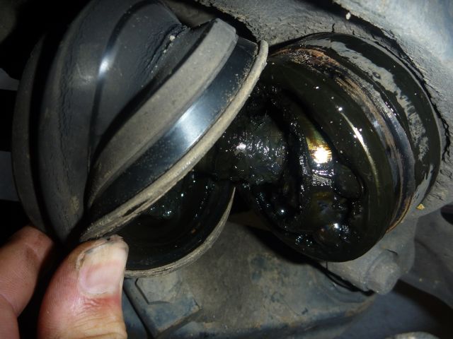

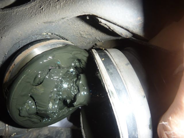

Ok so today I took a look at the CVs and I think I might have finally found something. First was the drivers side which appeared to have a good clean amount of grease. Then I checked the passenger side and it appeared to have less grease and be of a dirty sort of colour. I also noticed that around the outside of the housing their appeared to be 'blue' heat marks where the balls are. You can just sort of see this in the photo.
I also took the passenger side rack boot off and attempted to move it up and down and it did seem to move but only with a fair bit of force. How do I go about fixing this one?

Post by rubisubi » Fri Mar 19, 2010 10:45 am
Id be looking at the cv joints, my MY brumby used to have a bad wobble at speed and didnt have the typical cv clicking, changed the cv and was smooth as after that.
Post by TOONGA » Fri Mar 19, 2010 11:33 am
going by the grease in your passenger cv I would get the whole shaft out and clean both ends down and regrease them then put it back in and alot of your problem shoud dissapear
Post by Alex » Fri Mar 19, 2010 11:56 am
TOONGA wrote:going by the grease in your passenger cv I would get the whole shaft out and clean both ends down and regrease them then put it back in and alot of your problem shoud dissapear
amen to that.
looks like old grease which has had a fair bit of heat go thru it.
whilst the shafts out change the boots, it just makes things easier for the future.
