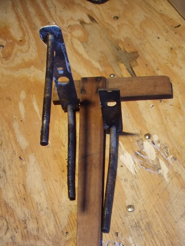

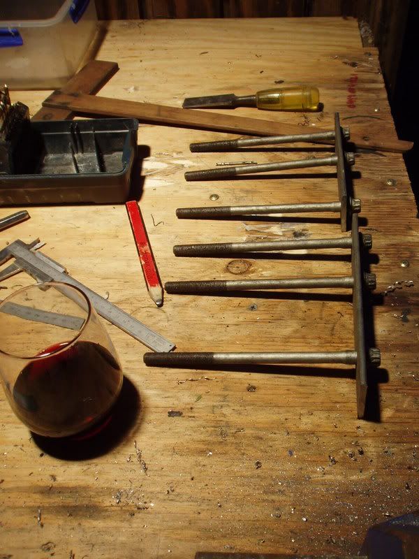

After buying the WonderBrumby Mark 2 and transplanting the goodies into her I have had awful trouble keeping alignment on the front tyres.
Fair enough that I have jumped it and raced it and hauled tray loads of brickies sand up hellish gravel hills...
and its a 280 horsepower drivertrain...but these tyres were rooted in months.
At $160 a pop I was getting shat, quickly.
I found the problem..

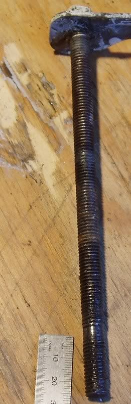

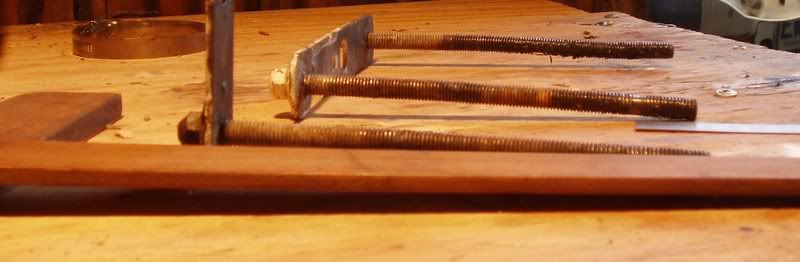

Front crossmember lift bolts (or not really in this case).
2 out of 3 and those 2 are mild steel threaded rod!
Snapped top plate and very stripped threads where it counted.
Bugger.

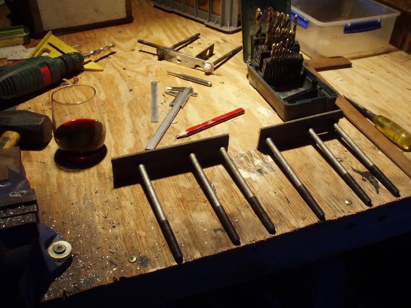

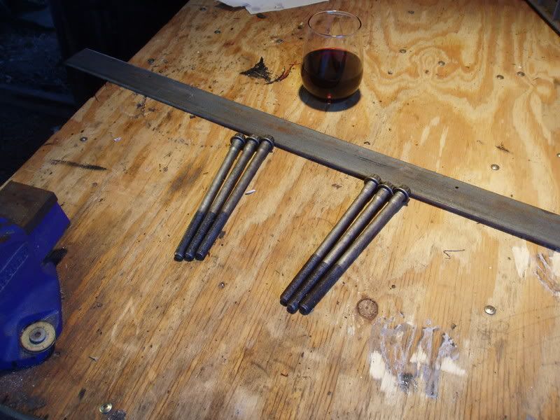

Firstly assemble a trustworthy team...
Then some bits... In this case I used some EJ22 head bolts; about 20mm long but who cares, at least they are High tensile!! 6mm plate will be supporting it.
There is a huge difference between 3mm and 6mm when it comes to your life hey..

Commercial grade stemless red wine glass Stuart...almost impossible for even me to spill.
Yes they do even stay on the bullbar for a short spin around Cranbrook.
Tested.
Lift was in there when I purchased her. Origin unknown.
Brown trousers when I found it though.

BRUMBERTY wrote:Lift was in there when I purchased her. Origin unknown.
I'd reckon! That's crazy dodgy... I don't think the wacky shop would even go that far!!!
Glad you found it before you encountered other problems with the front end - like it falling out completely!

Post by AndrewT » Sun May 18, 2008 2:33 pm
yer we've always just used the bolts that come with the lift kit. I don't know many people who've made their own lift kits from scratch but yeh, you'd definitely use propper bolts.
Most of the pre-packaged lift kits I've encounted only come with the bolts for the engine crossmember not the little upper plate...normally you have to bash the standard bolts out (they are tack welded in) and use the standard upper plate.
Naturally a dirty thick bit of flat bar is better, that's what I'm going to be using on the monsterwagon.

for best results u would use shorter bolts at the top n then short bolts at the bottom giving it much more stength
but the head bolts should hold up if it happens again i would deffently b puttin short bolts top n bottom

90brumby wrote:for best results u would use shorter bolts at the top n then short bolts at the bottom giving it much more stength
Where are you putting the short bolts dude?
They are all the same length and going through the crosmember..lift blocks and then frame rails....I fail to see where you could shove ashort bolt.
1989 Subaru WonderBrumby II

Post by vincentvega » Mon May 19, 2008 9:21 pm
this is coming from the guy with a liberty rear end bolted to the tray of his brumby!
you cant use shorter bolts in a proper lift kit with crush tubes. You can with C section but thats a whole other kettle of fish.
your head studs will do fine! good thing you spotted the problem mate

i think Tristan was talking more about the 4 Inch Lift Kits as they seem to have 2 sets of bolts for the cross member lift brackets.
top set bolting the bracket up to the Chassis and bottom set bolting to the Cross member.
they are also quite a different design to the crush tubes.

Regarding tyre scrubbing: I have had this problem, its usually caused by the alignment people. They just align the front end with toe in, as if it's a falcodore or something. Factory specs are 2 - 3 mm toe out. If set with toe in, front wheel drive in normal street use = equals tyres scrubbed on the outside. Feels a bit skittish in 2wd in loose surfaces too. Think about the engineering and forces when driving and it all becomes obvious.
