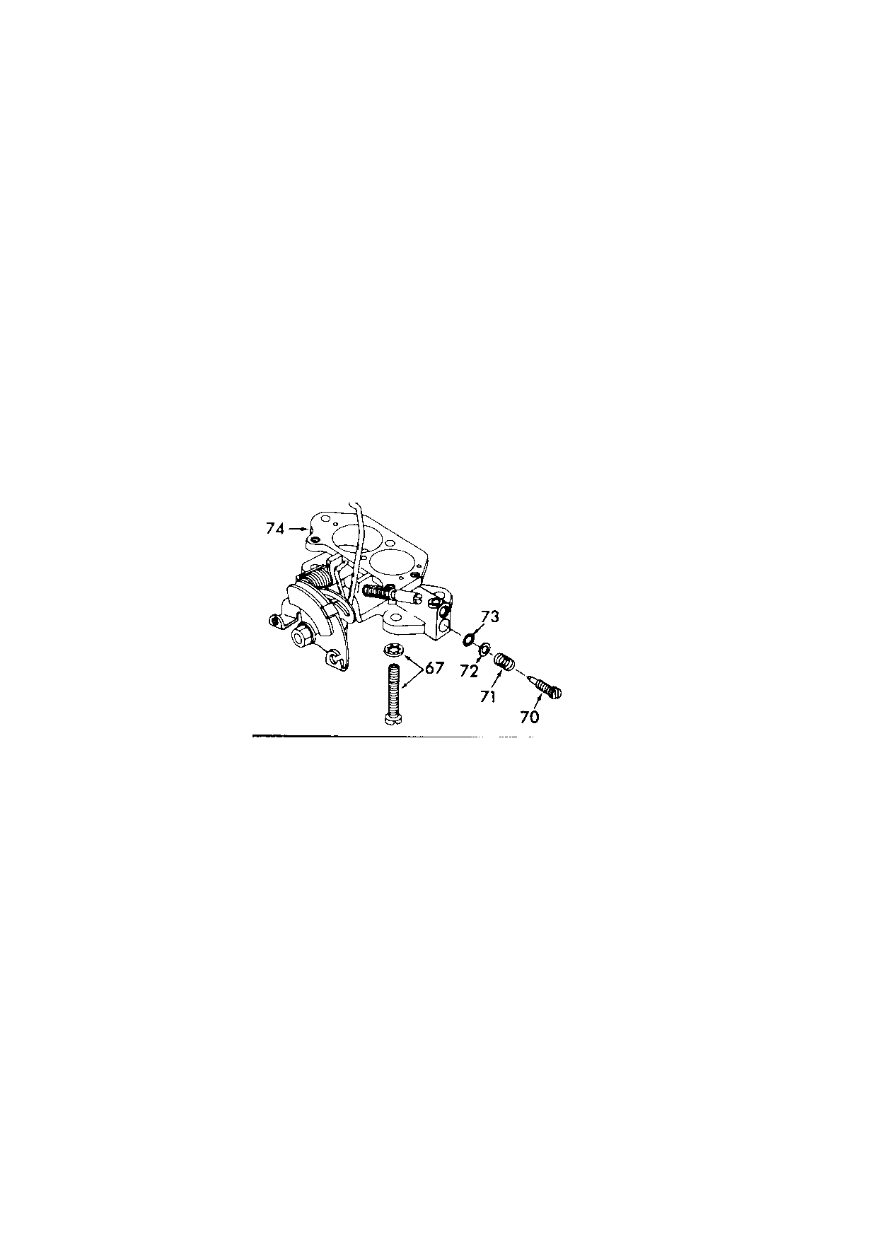

unfortunately while either taking apart or putting back together the fuel/air mixture needle striped the thread....... bugger.
nothing in my town to tap n' die such a fine thread pattern.
The solutions i have ATM are
1. to send the whole carbie somewhere for a total overhaul. probably cost more than $400.(incl postage) ....... too expensive!!!
2. find a throttle body or carbie that matches the bolt pattern at the manifold, that hopefully 1 of you guys may be willin to part with for a reasonable $$
(enclosed diagram of throttle body)
