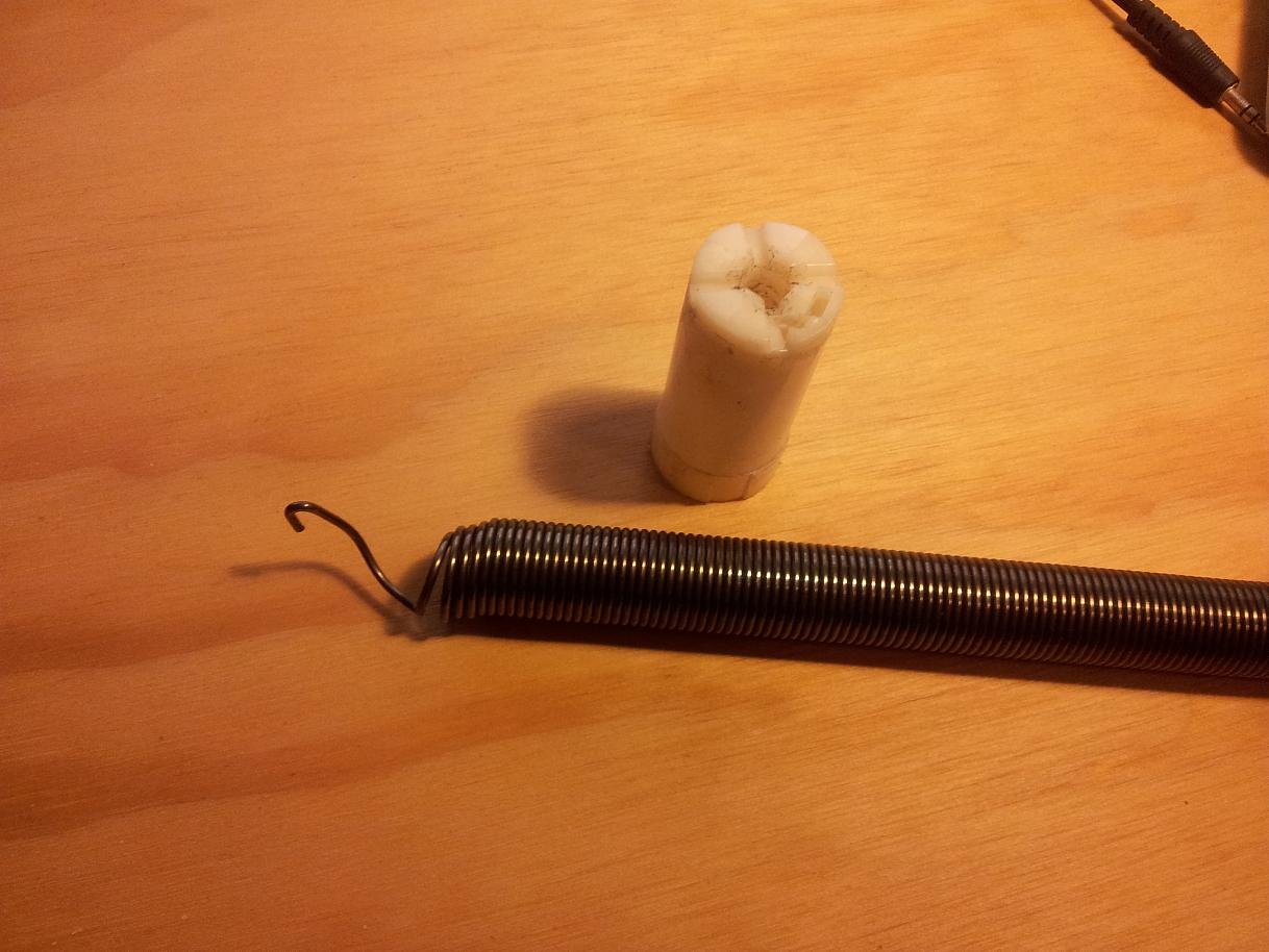

So yeah, I'm the proud owner of an '87 L-series GL Touring Wagon with what would be a spring-loaded vinyl cargo blind/cover for the boot if the spring-return mechanism wasn't busted. It's been bugging me for a while and I've finally decided to try to sort it out.
I found some info about how to disassemble a similar Subie blind here, and having pulled mine apart I now see that I have a broken plastic end-cap and a twisted-up spring, I guess maybe because of overtensioning at some point in the past. Photo attached - I'm pretty sure that the hook on the left-hand end of the spring is supposed to stick straight out!
I reckon I can sort out the plastic end-cap either by melting it back together with a soldering iron or adding metal as described in the Outback forum guide, but I don't really know what to do about the spring - it doesn't seem like it'll work the way it is. So, just wondering - does anyone know if it's possible to repair springs that are twisted up like this? Otherwise, do you happen to know a source for replacement parts for these covers? There are a few Forester/Outback ones on eBay which I might be able to raid for parts but they're either crazy expensive or in the wrong state; cheaper would be better for me.
Cheers!

Probably some more pictures may help but that end bit looks like it's meant to be bent over and maybe a roll pin (or the likes) sits in that groove on that plastic bit?

RSR 555 wrote:Probably some more pictures may help but that end bit looks like it's meant to be bent over and maybe a roll pin (or the likes) sits in that groove on that plastic bit?
I'll try to take more pictures, but because it's not going together very well at the moment I pretty much need a diagram. Bit busy for that right now, but I'll see what I can do when things settle down. :)
Quick description in the meantime, though, in case it will help others - on the left-hand side of the cargo cover mechanism is an inner shaft (with a rubber cover for sound dampening), an outer shaft, a white plastic end cap, and a spring, as well as the colour-matched plastic outer cover. The spring fits around the outside of the centre shaft; it's hooked onto the shaft on one end, and on the other end it hooks over a cutout in the white plastic end cap (which is the thing that's broken on my end cap). When you pull on the blind, it causes the outer shaft (and the white end cap) to rotate while the inner shaft (and outer cover) remain still; as the spring rotates it creates torsion - so when you pull out the blind, it wants to roll up again. The cross-shaped slots in the end cap match a small pin which runs through the inner shaft; the tension in the spring causes the inner shaft and pin assembly to lock in the slots when the end caps aren't pushed in, e.g. when you take the blind out of the mounting brackets in the car. I think the idea is that if you want to take the blind out of the car partially extended and roll it up manually in order to increase the torsion and make it return faster when released, you can.
I'm pretty sure that the spring in the RHS mechanism is only there to cause the mechanism to lock on that side when you take it out of the car; it doesn't seem to be for torsion.
But yeah, if I fix or replace these parts and can get the mechanism together again, I'll take some photos to show it more clearly.

Bantum wrote:I'd say - If all the parts are still there & in good order ie: not broken, you should be able to put it back together ... :)
Note : It is possible to carefully bend the spring back to it's original position, you just might need an example to follow ... ;)
My end cap is a bit of a mess right now - the slot the spring fits into is broken - but it might still be fixable. The spring is hard annealed or something though; seems like it'd break before it'd bend much, but maybe if I hit it with some heat and then hammer it or something I can get it back to something like the original shape. Worth a try. Cheers. :)
