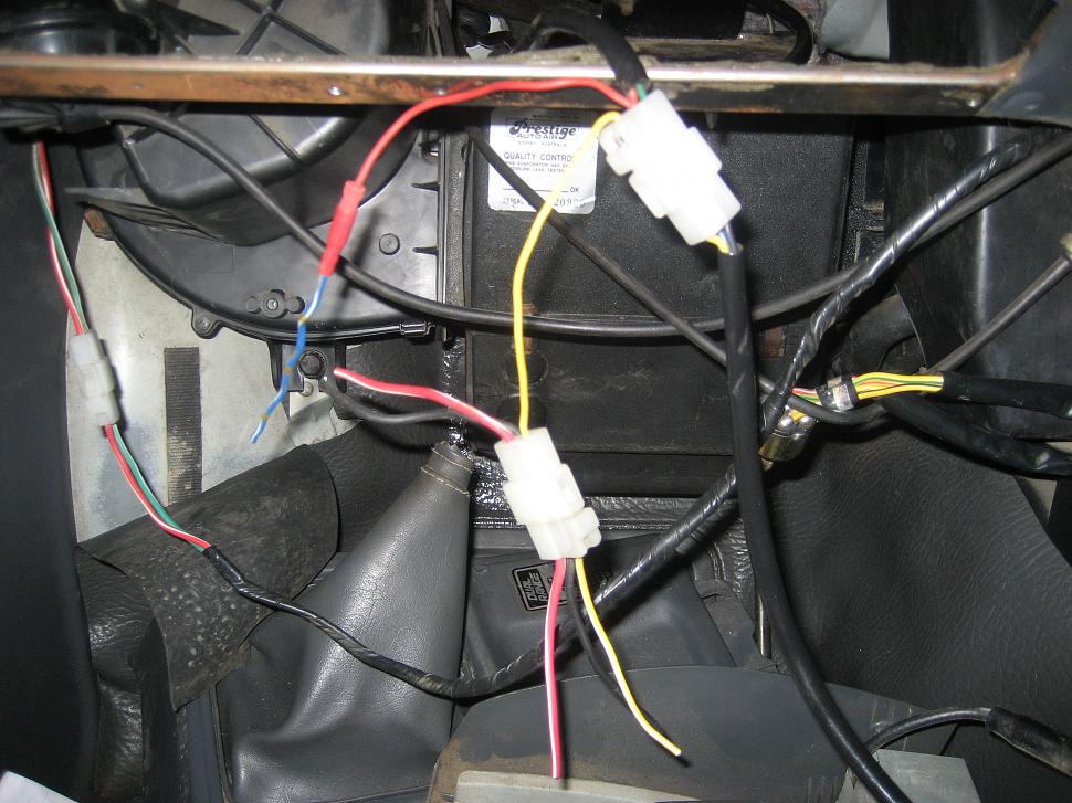

Need some help. I have installed an Air-conditioning unit from another Brumby into my 1989 Brumby. Everything is fitted, except the wiring. As I did not remove the unit, I need a little help with the wiring harnes that came with it. I have figured out that the long lead of the harness runs to the Relays, and the other end runs to the Evaporator, the Evaporator connection was in place, so I assume that this is correct. I am at a loss where the other wires go, with exception to the short lead, which comprises of three wires. One Yellow, One Black and One Dark Blue, these apparently go to the Air Con Switch on the dash.

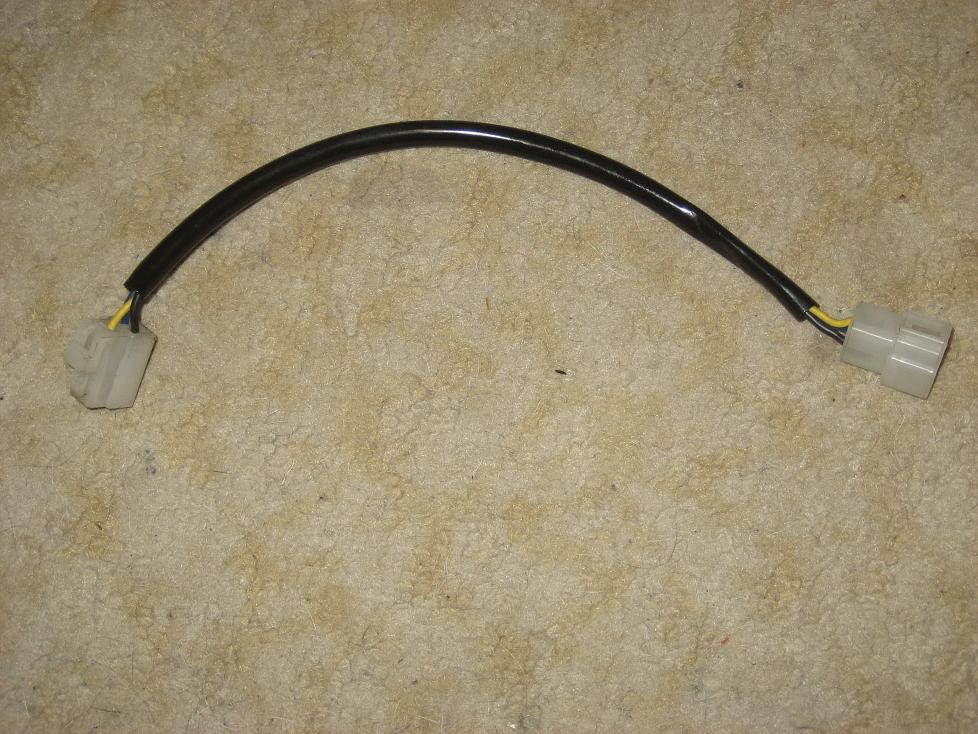

The wires in question are those shown in the photograph taken inside the cab. The other photo is of the short lead to the Air Con Switch.

PS maybe I shown include some colours, as the photos do not clearly indicate what they are. Top of upper joiner, one green, one yellow and one red with red loop. Top of second joiner, one yellow/white, one red/white and one black, bottom of joiner, same as top. Green/white and red/white in the background belong to the original blower unit.

^ Ok, so you've got some cut wires there, any idea where the other end of the wiring from those plugs go, I'm not talking about the cut ones, I'm asking about the ones that are not cut that you can check out.
And is this a lead that came with the kit?

Is it a factory unit or aftermarket ? I can see the sticker on the system, is that just a service sticker ?

Thanks for your replys. I found that the yellow/white, red/white and black run to the original fan switch, and what I have shown in the first photo is the connector that joins those wires. Whoever took it out has just cut the wires above and below this original joiner. The yellow wire connected to the second joiner must deliver power to that connector, as I now have a reading on the multimeter at the relays. To answer dfoy's question, I am not sure that it is a genuine Air Con, although it could be. My set up is a lot different to others that I have seen on this site. My control wires run out the same holes as do the pipes, on the passengers side. My relays are also situated on that side towards the front and near the radiator. I figured this out as there are two short leads that run from the relay to the compressor and another to the line filter. I also could not find a drain on the evaporator, so I guess I will find that when I start to run the system.
The other wire (red joined to blue) that comes out of the upper connector, as shown in the photo, is another power lead, so it could have been for a glove box light for all I know. I am taking it to get re gassed on Monday, and he is also an Auto-electrician, so I will see if he give my wiring the thumbs up. The only think that I am short off is the slim line thermo fan. I have an additional standard thermo fan, and I thought that I could modify it to fit, but as most of you will know, it don't fit. So if anyone out there has a slim line fan that they want to sell let me know. I live on the east coast in Queensland. Thanks Buddyboy

Well, I am now looking for a Sanden SDB705 Model No 7073 compressor, so anyone out there in Subaru Land, has one or knows where I can get one, please let me know. Apparently the SBD705 has been replaced by a SD7B10 model 7073, just to make things a little more confusing. This compressor came standard on a Subaru Fiori, and I believe could also could have come on early Suzuki Vitaras. Other than that, the "Sparky" said that the wiring is fine, and I can pick up the ute in the morning, less the compressor of course. Just had the hottest three days here on the Gold Coast, so I didn't miss the Air Con at all. I am hoping for better luck next week. Special thanks to D_phantom got your e-mail today.
