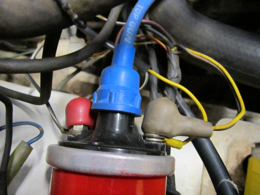

Post by Tozzy » Sun Dec 11, 2011 9:32 am
Just took a picture of mine.
Yellow(-) and Black/White(+) from Dizzy.
Black(+) and Yellow(-) from wiring harness
Black/White(+) from harness
Hope this is helpful

Post by alang » Sun Dec 11, 2011 10:07 am
Tozzy wrote:Just took a picture of mine.
yes it helps allot thank you Tozzy :D
